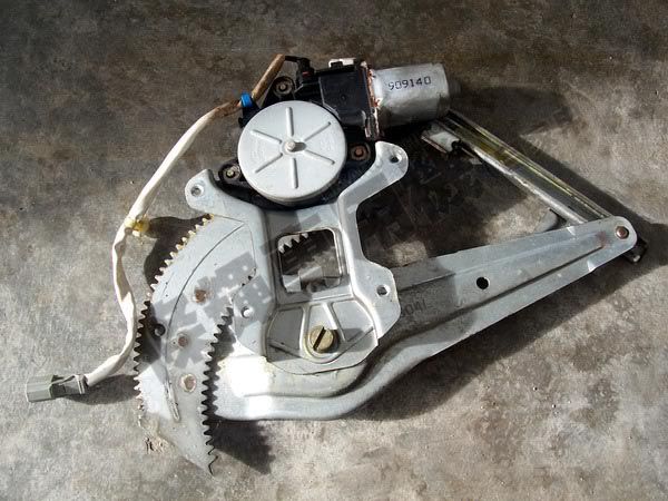

You will need the motor, relays, wiring harness, power window switch and the power window regulator.
You won't need to swap door panel, just cover up the hole with some grommet.

Xtreme77, I still got the front passenger side power window motor with regulator if you want, also got a set of power window switch mechanism if you would like to have.
