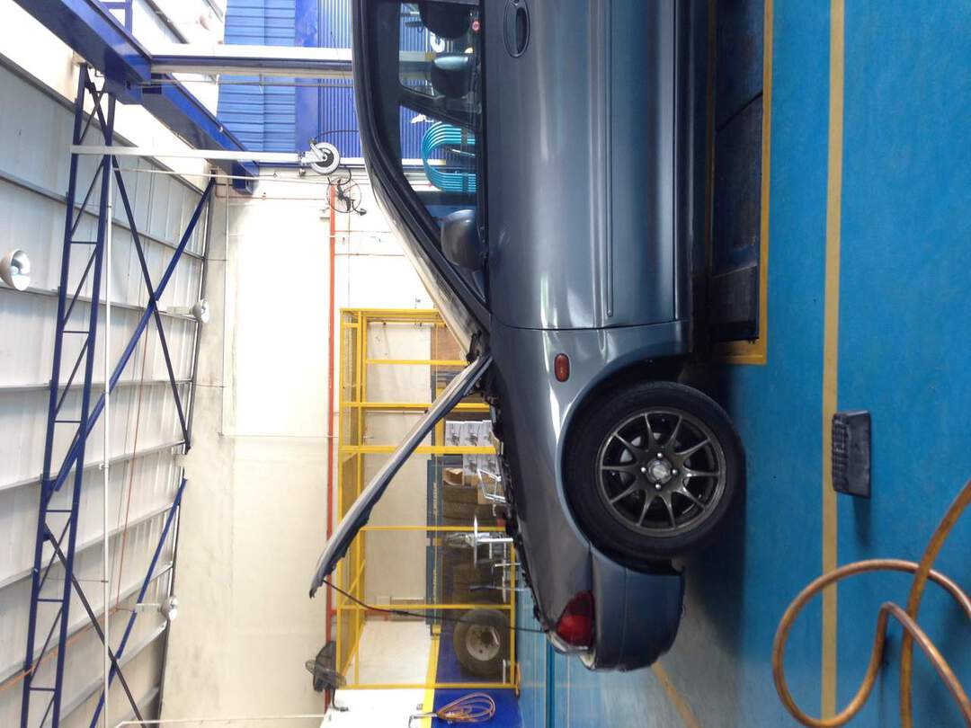

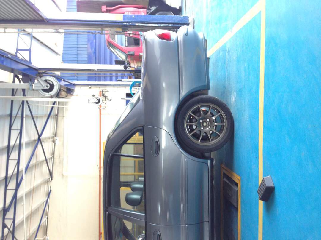

1k budget can go for taiwan/gombak made Mine's hilo body shift coilovers. I'm using those on my wira sedan at the moment. Got it from Sato Auto Acc at Puchong for RM830 with GST. Installed it last Saturday. Since you're not looking for comfort, I guess this will work fine for you. No need to compress the spring to adjust the height coz you have the body shift function. Preload can be set accordingly as well without messing with the height. So far handling is good except for minor bounce on uneven road when driving more than 110kmj. But I think it's due to the suspension still new and haven't really set in yet. Pictures attached are my ride after installation. I set it a bit higher yesterday coz it's too low for me.
