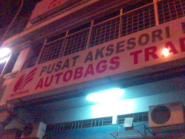

Custom plug cables at Autobags in Kelana Jaya.

merv is this the shop?
