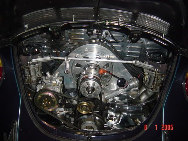

RS4wd said:
bro,
wondering the 2nd pic u posted....looks powerful dude!!
was that engine sourced from porsche?heeh
no porch engine lar...thats my fren...it spend for that machine bout 15k
that is very good street engine....
