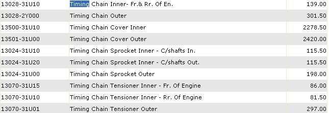

wah like that means i need to change my timing chain oredi lor .. any indication of cost? found these items under timing belt.

CGUI: TIMING CHAIN ITSELF COST AROUND rm5XX-6XX ONLI.........EXCLUDING WORKMANSHIP N OTHER PARTS......BUT PLZ LAR.....IF U OSO DOWNGRADE NOBODY ACC. ME LIAO.....IM A LONELY 3.0 THEN.......MUAHAHAHAHAHA....HELP ME!!!
