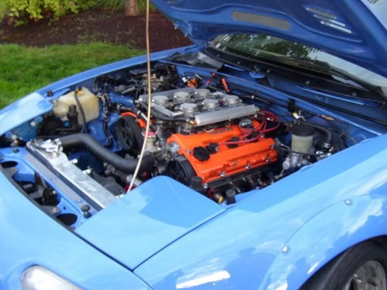

maybe can try supercharge a mita engine:
http://i5.photobucket.com/albums/y186/kongmunkit/B-specsupercharger2.jpg
http://i5.photobucket.com/albums/y186/kongmunkit/B-specsupercharger.jpg
yes..boon ..u are right...battery must be relocated to the rear.but i still believe that v6 bot can be done.since its a single turbo setup, the turbo unit will be on top of the gearbox.and yes the intake manifolds and many other parts between k series are interchangable.
