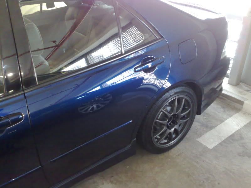

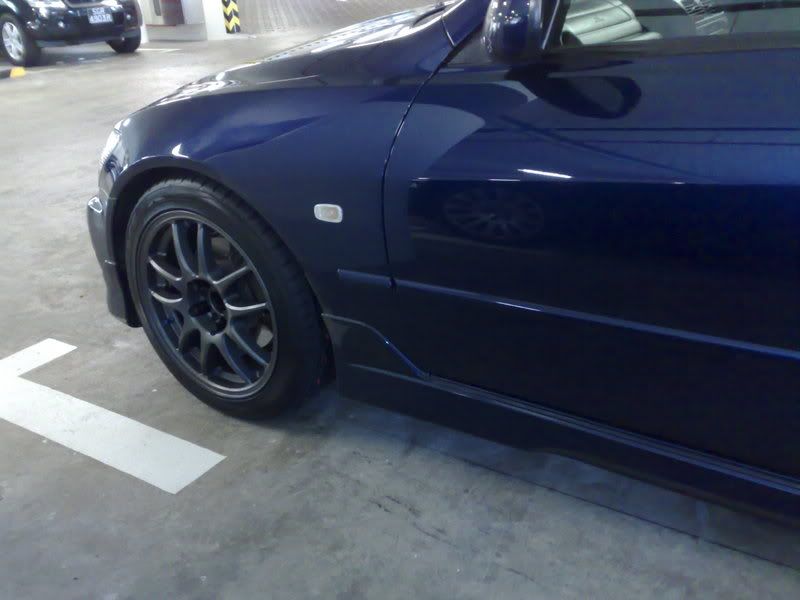

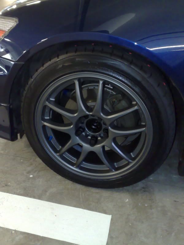

Decided to save some cash and go with Work Emotion CR. Got it from Yap Bros. 17" 8JJ. Traded in my Potenza G3 too for a new set of Toyo T1R. Sounds quieter than my G3 but time will tell. Any comment on this tyre? Profile is 225/45/ZR17. Right profile?
Was deciding between Prodrive GC014, GC010 or this. Decided to save up the diff cos' not sure how long I will drive this car.

Btw, any comments on this rim??
nice rims...but wud hv gone with 18 inch..
Toyo T1R are great tyres...quite noisy actually but very good performance..i'm on them and feel very confident on wet roads especially..
like urs, i also maintain the gap between the tyres and fender..
lowered car will make the car soo much nicer..but have to compromise hitting bumps etc lah..
I actually find the toyo much quieter than my potenza G3. Sidewall too soft and feel my handling suffers a bit compared to G3.
18inch? Thought about it, but the rims and tyres are more expensive so no point. 17" is good looking enough.
Yeah... it's chio to have lowered ride but i have my shares of undercarriage scratches etc...
Nice rims and good tire choice...:)
How much did it cost you?. If you like driving in the wet, then The T1R is a good choice for you.
