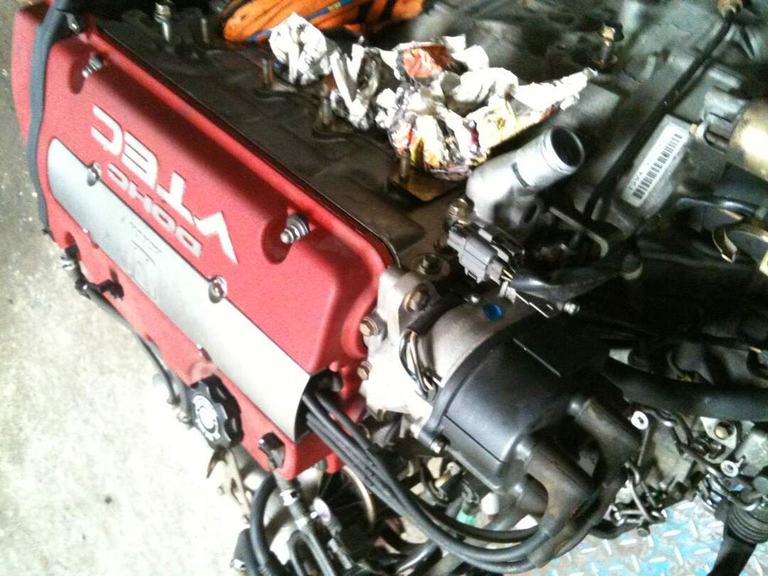

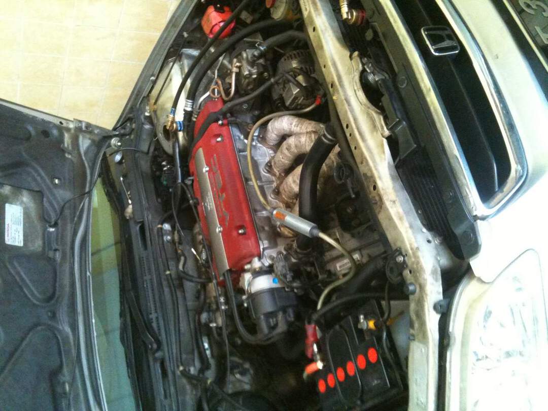

picture didn't take during the process only before and after...
comfirm have to custom made a drive shaft for left hd side.....:banghead:
for those s84 or s86 user who want to up grading to h22a, maybe u can just buy a engine + gb . no need buy a half cut.
then the bigger dics + mt shift + paddle... or just buy a prelude half cut which is much cheaper then euro r !!:listen:

my machanic rearange the wiring so it can run the engine with prelude or original euro-r ecu. but for some technical isue, the engine check light will light up when use the euro-r ecu. still no test drive yet. will report after every thing is running smooth.
