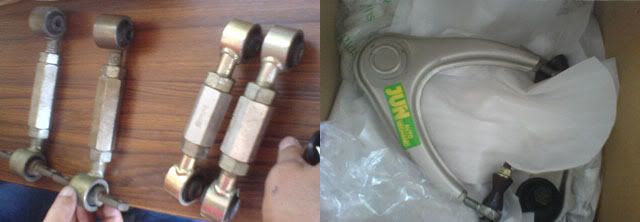

Now that's what I call camber kits.. notice my hand with the car key and you realise how built those things are. These sets are for an EK...

shiroitenshi said:
Stuff I want, but the price means more delays for the B20B.
but price can make you scream in terror oh!...
BTW, how much did those costs? I'm searching for Adjustable front Camber kits for my DC2. PM'd Chris, but he hasn't replied.
The ones in the picture are second hand, courtesy of a friend in japan.. but still costs more than 2K+... (since they're pretty much sitting around in a show car.. or so the guy says) new ones are rumoured to be over 4K for front and rear...
(O_o).... this definitely epitomes expensiveness....
The Jun camber arms are really different, and there's near zero possibilty of slipping like the ones that use separate piece for the top knuckle carrier thing.
Kinda sad that it costs a bomb... (>_<)
