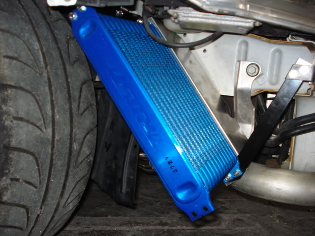

In comes the transmission cooler. Most stock automatic car transmission coolers are just a single line of copper that's part of the radiator located in front of the radiator which quite frankly is useless for cooling a hot transmission. Aftermarket transmission coolers are essentially mini radiators that have more cooling fins to help cool your ATF.

Just a note :
Automatic transmission is Hydromatic (powered by moving fluid). Autos have a built in pump that circulates ATF in the gearbox. The Torque Convertor is designed in such a way that there is a lot of heat generated. Hence transmission coolers would help greatly.
Manual Transmission is stationary and rotational. Air cooling is more than sufficient however if you want to install a cooler, it's possible but you'll need to add an additional external pump to circulate the gear fluid.
how about manual??
Manuals don't generate as much heat compared to autos because autos have torque convertors. So it's not necessary but if you want, you can add a cooler but you'll need an external pump because manual GBs don't have built in oil pumps.
