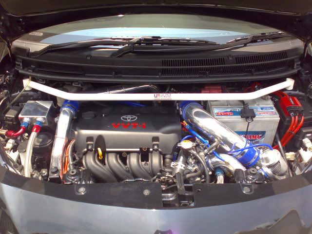

so far only got 1 member install turbo in new vios model with auto...bro CCS ... all the installation done by GTAuto in sunway...
here is the pic
