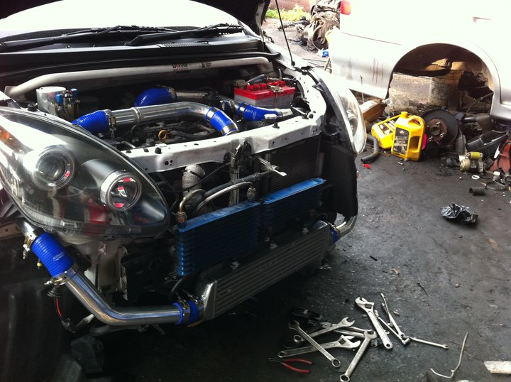

if the thermostat & a big radiator is in place but still overheat, mayb he needs an oil cooler..
i think Izso can help DIY that
:biggrin:
:biggrin:
Haha! Easy la that one! If the the fella wants to install a oil cooler and has bought all the bits and pieces I will go to his place and document the DIY install!

my experience... water temp and oil temps usually rise to about the same temp.
say oil temp is at 95deg, so will water temp. so it is worth while to look into oil temp as well if all effort is done to lower the water temp. oil cooler may be required to bring down water temp as well.
