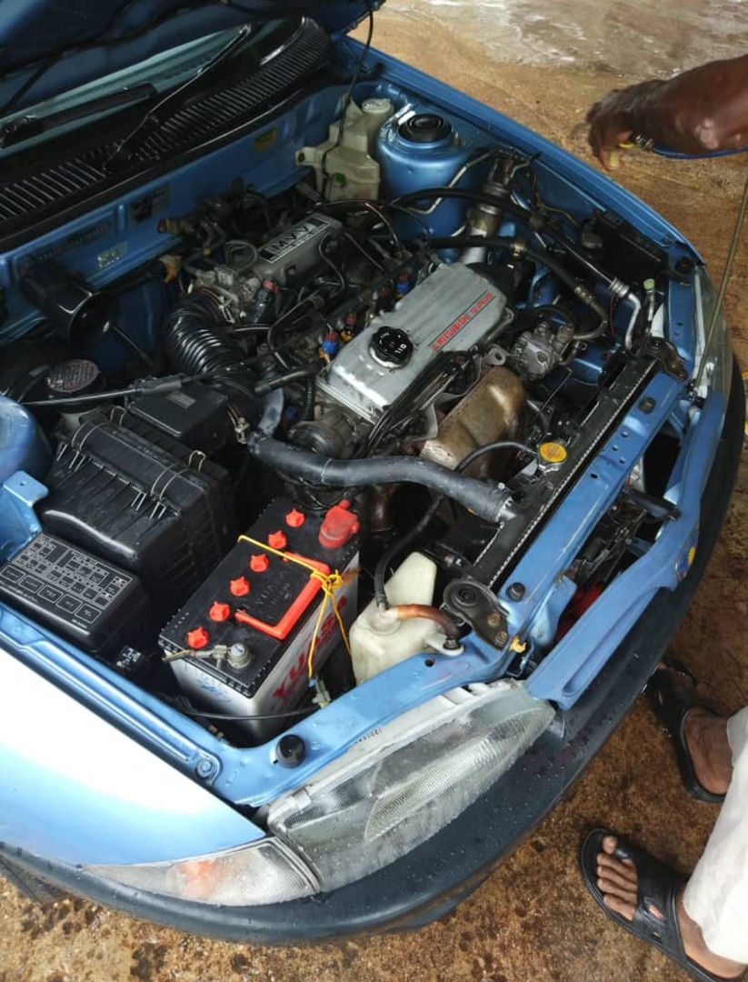

Btw, Mvv engine is really more powerfull when I try although AT.

MVV! That is rare. I wonder how much difference of performance there is compared to my MMC.
Your one is 4g15 mmc or? I never drive MMC so dnt knw how to mmc feel like, I only can compare with my vdo mt, Mvv is easy to hit 160kmh. Mine one after 130kmh already slowly up, if no compare with 1.6/1.8 engine it was better in 1.5 category
Mine MMC. Mine also easy to hit 160kmh. I don't know what is considered easy for you but mine not too long to reach 160.

Your stock engine? Maybe mine vdo for speed is worst, just fuel consumption is good.
Before I planning to upgrade 4g18 crank, find a used turbo kit and low com piston to fit in. But forman say vdo cant be tune, online survey also said auto relearning, need to use standalone. Standalone very very exp But they said vdo system able work with Unchip or Work EMS. Now a days I only can found unichip in market and I go tuning shop ask for some details, thy said VDO can use with unichip but one things is cannot remove rev cut(not sure 6.8k or 7k cut)
Engine stock. Only things I did is 4-2-1 extractor, 1.7 inch exhaust piping with a bullet/resonator and twin tip muffler from Wira 1.8. Also I had my ignition timing advanced which is adjusted at the distributor. That's it. Engine oil is on fully synthetic 5W-40 and this is important too for engine performance.
