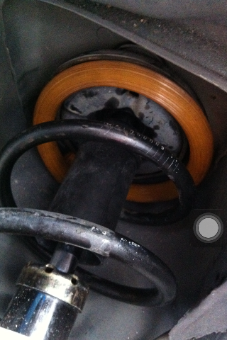

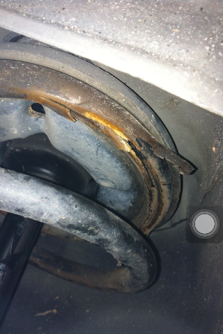

Apparently, it's because of my springs. I am using Eibach and in original, the upper and lower coil portion has a layer of rubber on the spring. This is to prevent the spring from any noise if we brake hard enough, where the circles of the coil hits each other. The layer of rubber cracked.
So my mechanic took off the rubber layer and replace with water pipes. Yup, cheap and it works!

Oh yes, just reminded me. When I brake hard, I get the tak tak sound last time too. This happened after I slot in the 4 pots caliper.

That's a great fix!! I like it!!
Simple, cheap & problem solved :)

bro,metal rubber metal.sooner or later its gonna eat a hole in the rubber hose.the problem same as the plastic bearing on top the mounting.i was told using sport spring wut so ever brand shorten the life-span of everything on ori shock,bushing,bearing,mounting.either go ori change whole suspension same branding.
Bro, anything that is moving, will have wear and tear. Even stock engine rubber parts last you the most of 5 years. Adjustables are much better for sure in terms of handling performance but it needs servicing and replacement of rubber seals, etc too.
I'm not sure the cheap/cute rubber hose will last me for how long but I know at least for the next 1-2 years, it'll be problem free for me.
