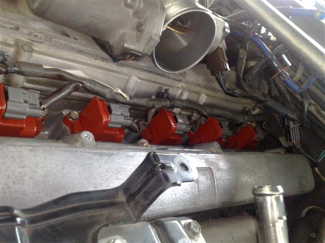

P/S : I also used this urethane to coat (3 layers) my coilpacks to cover any hairline cracks preventing any misfiring :)

A little off topic but may interest some. This would be my handsomely coated coilpacks :)
