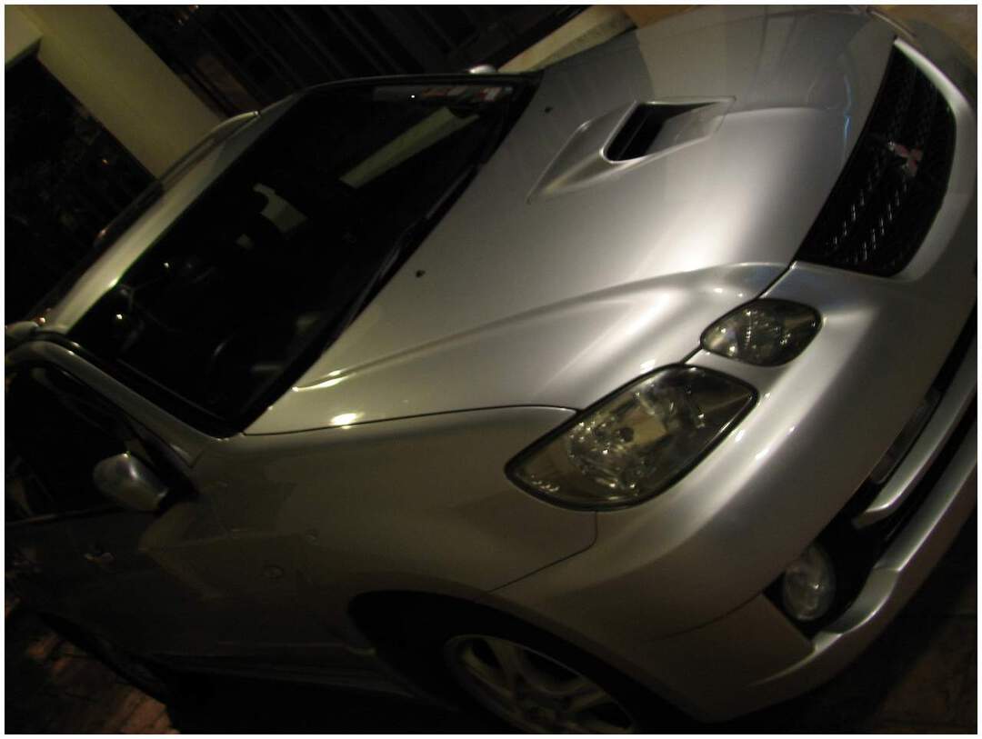

Please share pictures of your proud rides. Allow me to start. This is my humble slow tai-fun-shue (big potatoe). :)
My sleeper with its mods...
I don't have 100++k budget to play with, I wanted a family car with enough room for the kids & stuff at the back, comfortable for the wife, practical for daily use, and yet packing some decent performance under the hood when required ......or provoked =)

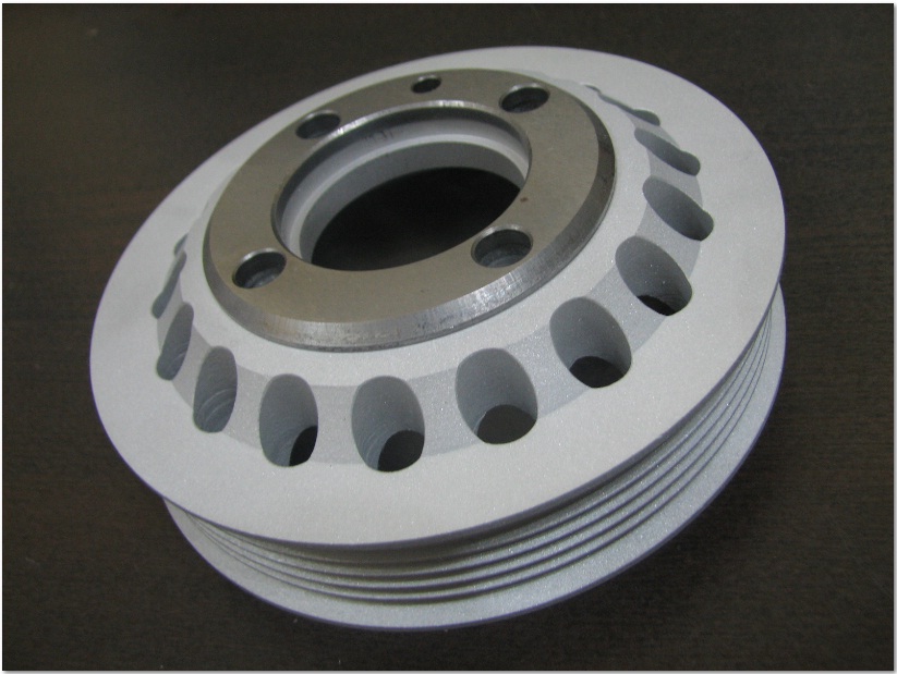

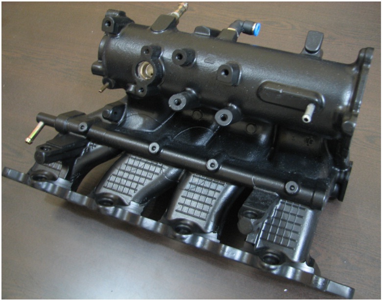

IMPROVEMENTS: Moving the 1600kg Airtrek turbo from a standstill is a huge challenge, its not very responsive, especially for a car with an autobox, AWD, a very tall final gearing & zero boost at low RPM. My quick and easy solution to improve engine response...a lightweight undersized aluminum alloy main pulley to reduce parasitic drag & an Evo 7 intake manifold with shorter runners for quicker response. Notice the intake manifold is thermal coated black to keep the heat out.

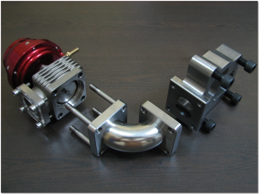

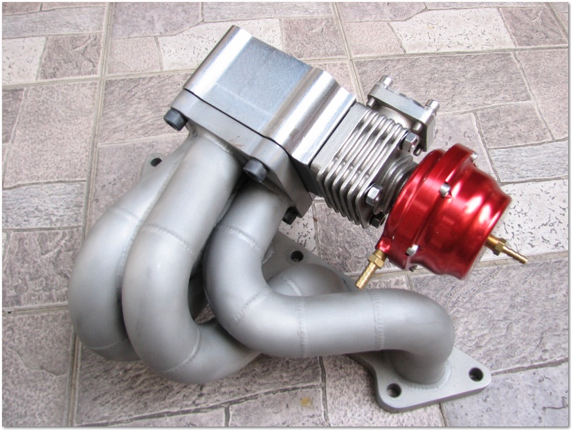

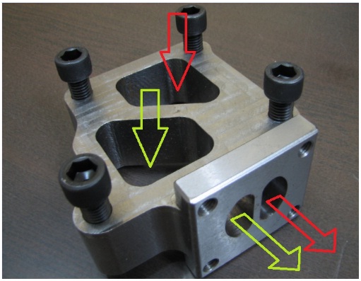

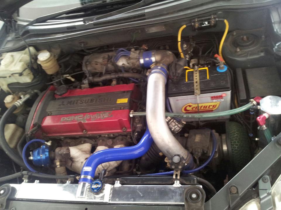

Small & old technology TD04 turbo produces boost from 2500rpm onward, but not efficient & pushes out pretty hot compressed air. Upgraded to a twin scroll TD05 with from Evo 9 GTA, works best in low->mid rpm range. I wanted the external wastegate to mount as close possible to the turbo for optimum boost control, thus a custom made wastegate adapter was computer designed & CNC machined out from a chunk of steel.
Feeding the turbo with hot exhaust gas is accomplished with the help of a Tonnka exhaust manifold. Mechanical side of boost control is handled by a Tial external wastegate.
Installing a larger turbo in a Airtrek turbo will required a radiator fan re-location. There's just isn't enough room to fit the turbo & fan in the engine compartment. A 3rd party OEM condenser fan was chosen to replace the stock fan, installed before the radiator like Evos. Had to trim some metal of the front crossmember to fit the fan in there. Also, I never liked the top mount intercooler since day one, here's my FMIC setup with 2.5" aluminum piping all around.

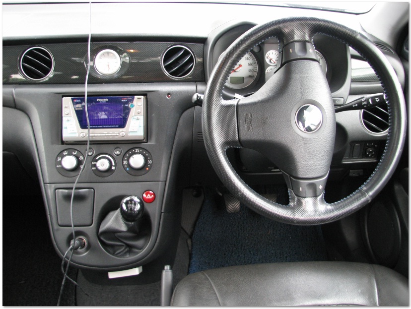

AUTO -> MANUAL 5-SPEED GEARBOX CONVERSION
The ordinary Airtrek turbo center dashboard, with the not so ordinary stick shift in the middle.
Probably the toughest part of my Airtrek project. Most would opt for a straight forward, no hassle approach by using an Evo's floorshift and center console, but I wanted to keep center compartment, arm rest & the shifter at its original front dash location.

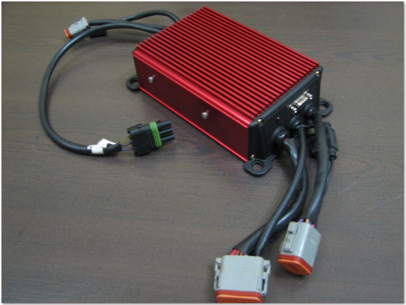

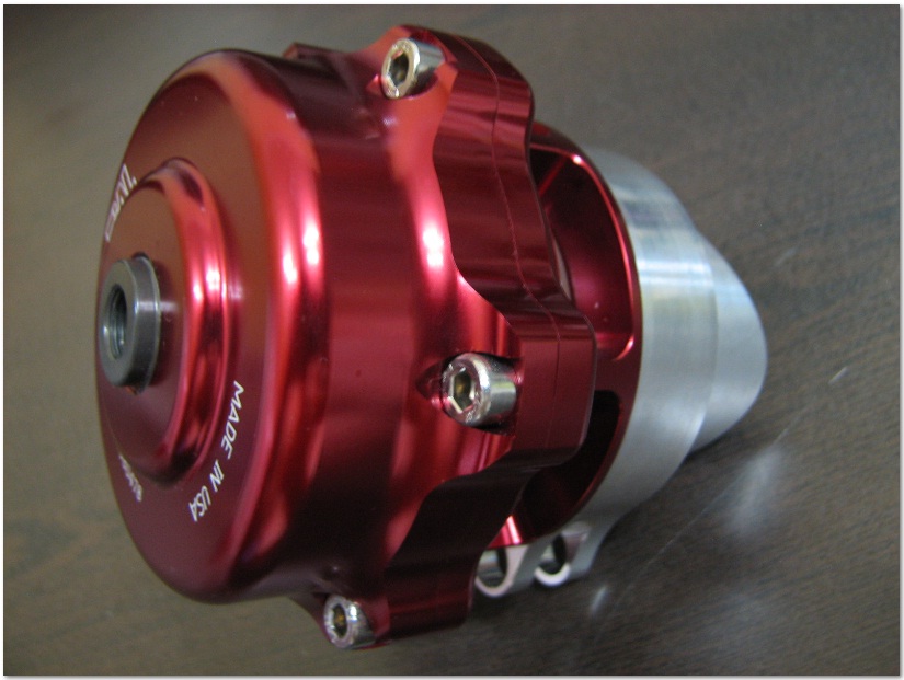

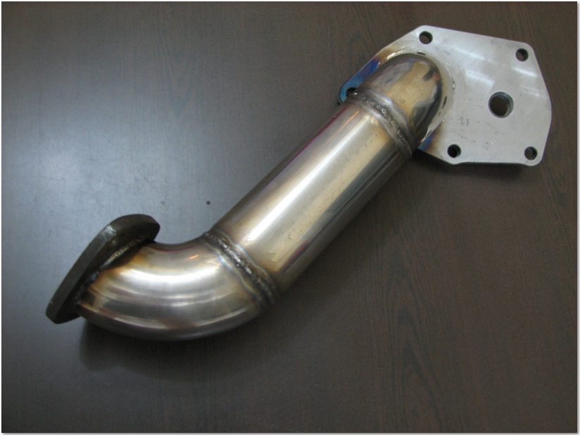

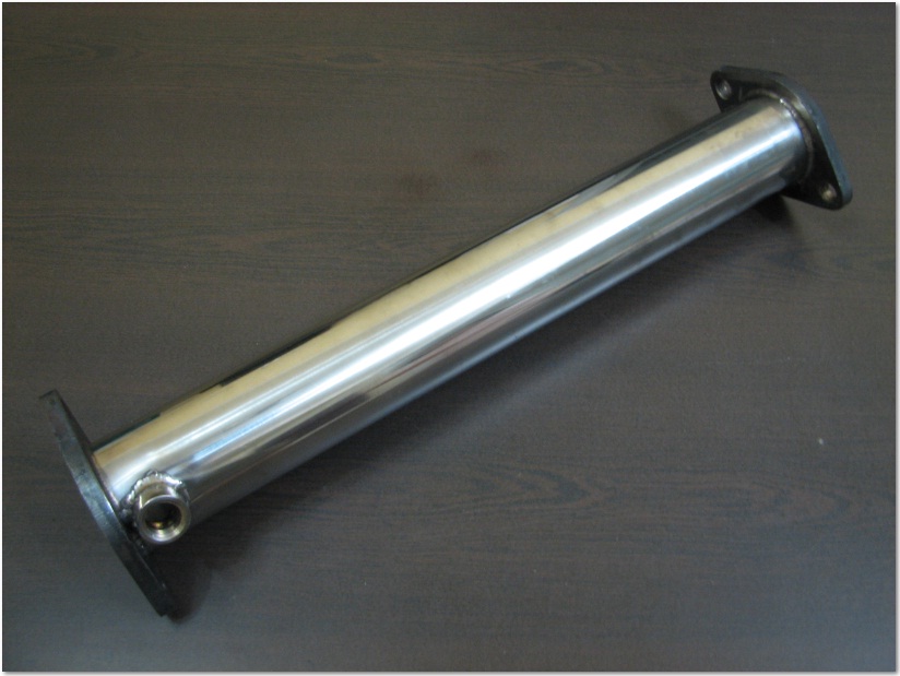

Current setup: Evo9 gta TD05 15G 9.0T, Tonnka exhaust manifold, 255-L/hr high pressure fuel pump, Evo7 cams, Evo7 intake manifold, Evo4 manual 5-speed tranny locked 2WD, custom 2.5" aluminum piping, 2.5" inlet & outlet FMIC, custom 2.5" downpipe, custom 2.0" to 2.5" turbo outlet, custom 2.5" decat, custom fuel rail, custom turbo adapter, lightweight undersized crank pulley with custom adapter, TIAL 40mm external wastegate, TIAL blow-off, Greddy boost controller, Greddy E-manage blue, Greddy timer, drop-in high flow air filter.
Stock items in current setup: 450cc injectors, throttle body, exhaust mid box, exhaust muffler, stock 16" rims & tires, stock intake air box.

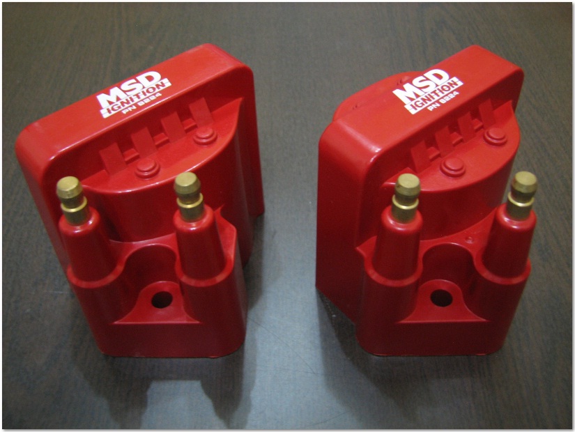

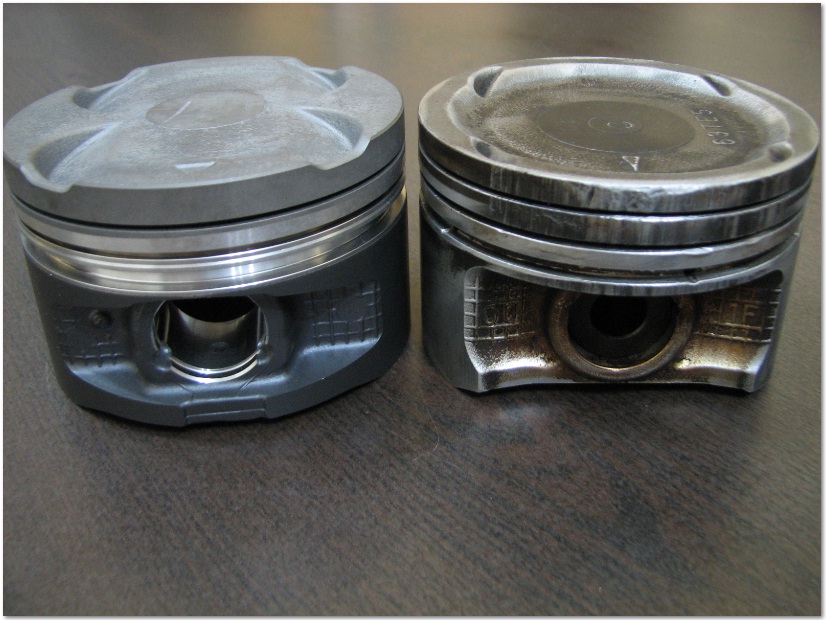

Future plans: 9:0 high compression forged pistons, MSD twin tower coil, MSD dis-2 programmable ignition, water injection.

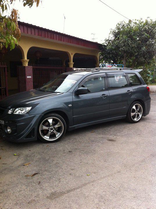

another damd airtrek
