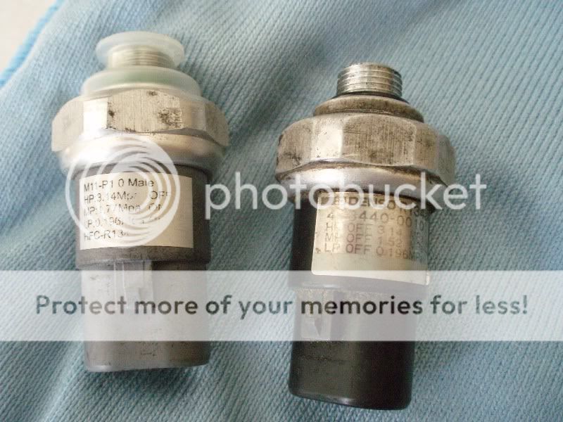

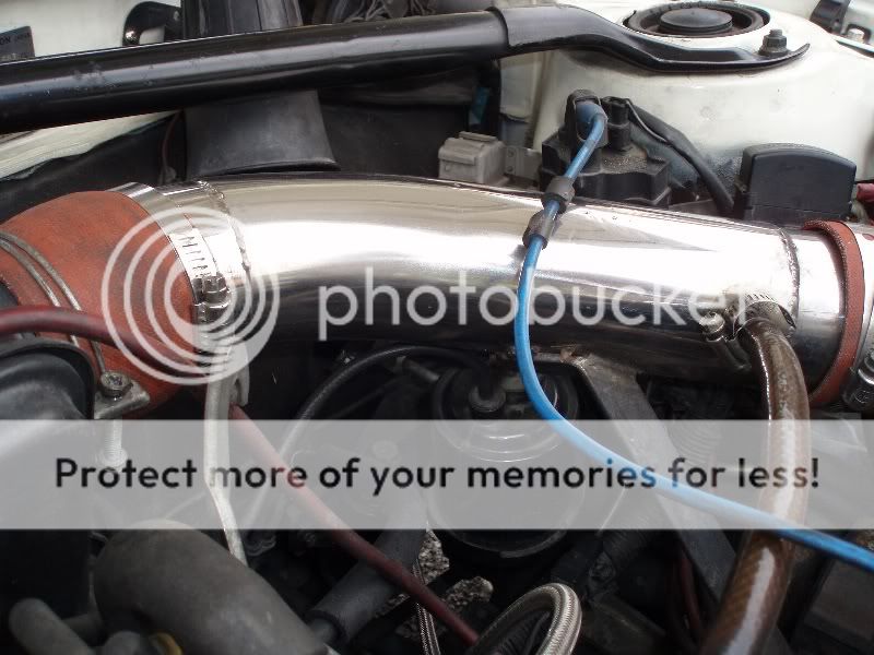

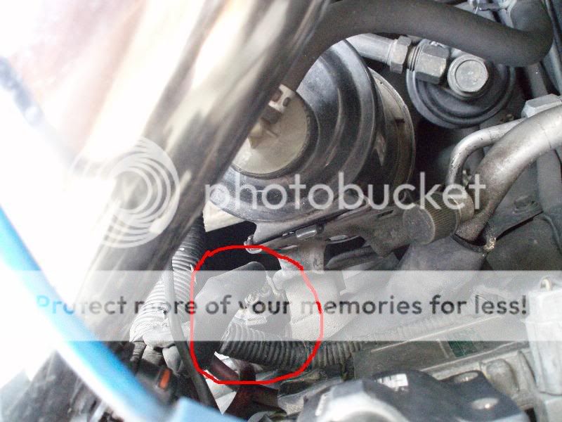

is think the cut-off switch looks like this ...
sensor pic
it sitting just next to that black cylinder box
here is the sensor, sitting on top of the L pressure aircond piping
denso and imitation...
Very thank you for hon_cs & chinozie sifu , very useful.... hope can get a cool aircond back be 4 new year..hahah..............

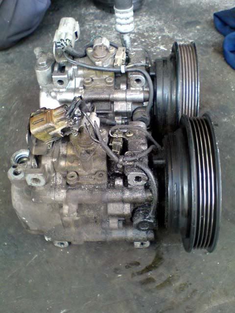

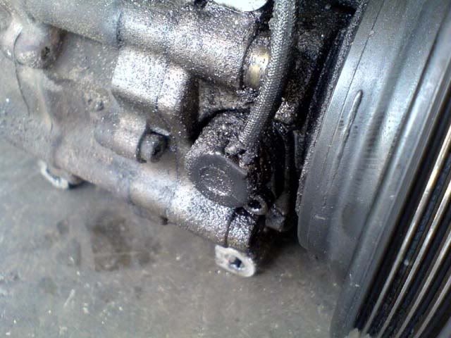

Tested repeatedly once car warm up in idle or u have drive the car for 10mins, open up the bonnet if u pore water on the compressor it will boil.
also tested repeatedly just let the car sit idle more then 6-10min it will cut n AC wont run back after 6-8mins or u direct pore water at the compressor it will direct engage back.
recently test again ask ac mechanic to dismantle all to do service, after service still the same even tested with other 2 unit halfcut compressor.
Already done alot of testing change those mention b4, still cannot solve been paying for gas refill money more then 6 times.....:confused:
also been test by 4 different AC mechanic, all do not have any idea.
