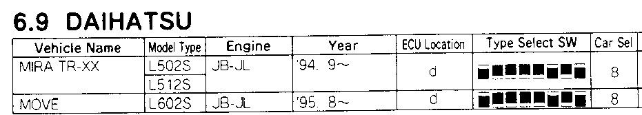

hi all..does anyone know how to set the car select and type select at the back of the safc 5 button for mira L2?:hmmmm: tq

hi bro..i didn't manage to get the tach signal from the N- pin...i tap the rpm signal from the IG pin..wonder y the N- didn't produce the tach signal..do u think the ignition system got any problem?and what is the IG stand for?is it ignition feedback?tq
Bro E-Tech thanks very much for wiring diagram.
todamax I had the same problem and had to do the same thing that you did, since it's working fine,i'll jus stick to that.
is it same the car select and type for L902s Jb-det 4 piston with L2 or L5? cuz my 5 button the rpm (red lamp) not working...:hmmmm: & can or not to modify the safc to remove the boost cut? help me..
