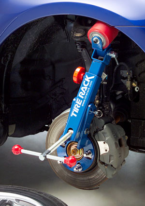

just get a steel pipe with a diameter big enough. stuff it in between ur tire and fender, get someone to drive a bit and you would have saved a lot on hiring ppl to do.

It depends more much bending of the fender, right?
The paint is dry and rigid and when fender is bent, the paint will crack....
Hair Dryer not hot enough - use a Heat Gun, like this

For step by step instructions for rolling fender see here;
http://www.rollyourfender.com/instruction.html
Yup, my service department have one like that. Nicknamed Industrial Hair dryer.....:biggrin:
But have to be careful also. Cannot heat on one spot too long, the paint might strip......
