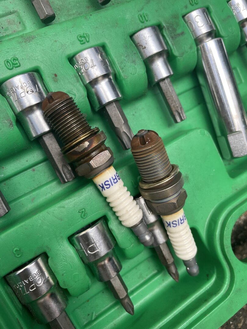

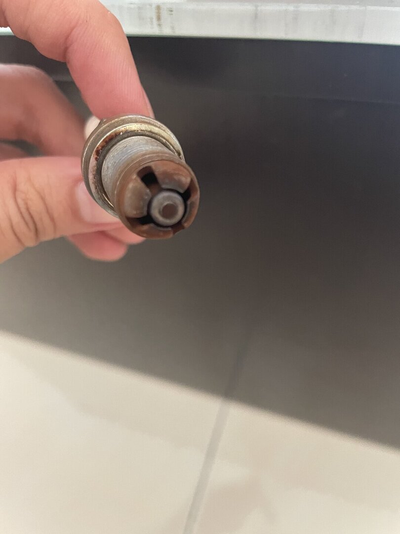

Jazz update
Send my car to my friend recommend shop for checking. After telling the issue to the boss & also tell him might be the spark plug issue. The boss also suspects the spark plug issue so he go and open out to check the spark plug and wallah is the plug issue. 2 of the plug is rosak. Replace a set of new spark plug and the chok chok feel is gone.

I said earlier your spark plugs costs a lotta money. And it's "Pedal" not "Paddle".

Are your k20 coil packs ok ah? Maybe one of your coilpacks are faulty

Want smooth clean tb, clean PCV valve, change new MAF/MAP, change new O2, change new ICV.
Every year I will buy a bottle of Seamfoam Spray or CRC intake valve cleaner to do some cleaning(Alot of white smoke after doing it,but after awhile is gone). But haven't try to open out the whole tb to clean it. Where is the location for the stock grounding? I had search but didn't find it.
While changing the spark plug had check the coil all is running ok.
