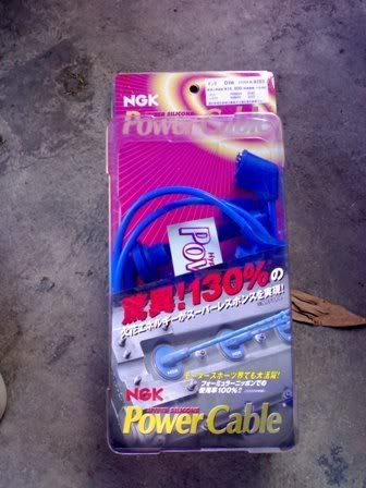

Two days later, the cables arrived. NGK Power Cables. Honestly, I've not even heard of them before, but at 16,800yen a pop, it must be decent at least.
As for performance... well.. what do you expect on a stock B16A ? Nothing!! (at least not that I can feel, that is) ROFL! I'll update on the performance factor if the cables last till my b20b conversion. Sparking is similar to the splitfire.. no difference in spark intensity (could be the coil being old....)
Visually.. when I took them out of the box.. I went like... 'eeewww' for the light blue colour. The design wasn't really appealing for me as well. I rather liked the bulky look of the splitfire, with it's black end caps.
But according to a review.. 'supposedly' 90% of japan tuners use this cable. (never trust marketing speak).
The sticker was kinda a letdown for me too.. white letters on a red border.. that sticker was headed to the nearest rubbish bin.
Anyway, if you're planning to get this cable, it works on the stock holders since it's 7mm as opposed to my previous splitfire cables at 8.5mm. Cable routing isn't as nice at splitfire, since I has excess lengths on certain wires. on the plus side, it's has tiny plastic clips denoting cylinder numbers, which is like a tiny useful feature, if you're trying to put back the cables on the distributor with the spark plug cover on. As if I do that often... (>_
Overall.. 6 out of 10... performance maybe on par with other performance cables, but the look and construction is uninspiring. NGK should really make the ends out of a different colour. (>_

Yeah.. what a letdown.. I'm back to splitfires once this one dies. (supposedly ithe NGK power cables lasts much longer than normal cables but then again.. never trust marketing speak)... for example...
130%? Wah! if I put it 12V at one end, I get 12V + on the other end? ROFL!! actual fact was that it reduces resistance by 30%, but tell that to the marketteers! ROFL!
