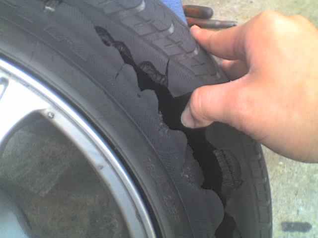

GOODYEAR NCT5 TYRE...There is no "steel cord/ply" at the tyre side wall lining..it contains only rubber..i'm almost done for when using this tyre, i'm travelling around 85km/h on NKVE when suddenly the whole tyre rips apart at the side wall...the car loose control and skidded side ways, but lucky i manage to gain control, and stop at emergency lane. The tyre is less than 1 year old, and still have decent thread lining on it..i always check my tyre conditions, and maintain my tyre pressure at 30psi..i can't feel any drag or abnormalities before this incident happen, and i'm travelling on a straight, smooth open highway..

no steel sidewall? i tot all tyres came with steel sidewalls nowadays.was the tyre over/under inflated? or maybe was cut by something on the road? what did the tyre shop say about this?
looking at the pix, it was cut by sumthing on the road. ive been using goodyear for years, nuthing like dis happens. nct5 is one of my fave, its not expensive pun compared to others on the same level of performance

Ratbit: Dude..most of the passengers car tires sidewall only come with "Polyester" and "Rayon". U can find that construction info on the sidewall marking on each passengers car tire. while some truck tires sidewall uses "Steel Belt".

anyway pls keep the tire and write to goodyear..let them investigate...and did u buy it new? or used? or has it puncture b4 coz sometime if puncture..the sidewall already damaged earlier.
