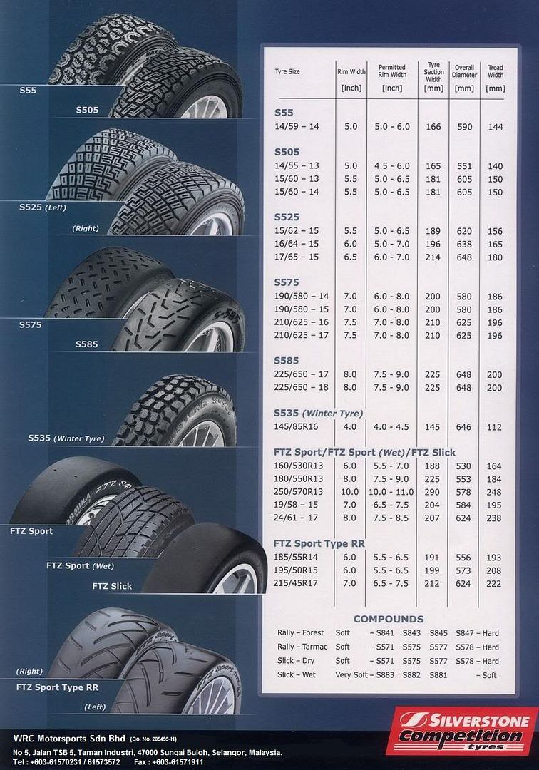

okay, for brand new silverstone rally tyres, you can get all of them from WRC Motorsport in Sungai Buloh. sample prices are 13" 14/550-13 s505 gravel rm175, 14" s505 Rm220, 14" tarmac rm280, 15" tarmac rm290.
for second hand rally tyres, you could ask the rally teams for any used tyres that they wanna sell. i know a few of them buys new sets for every round, like ian khong...
silverstone rally tyres are one of the best rally tyres out there. WRC Motorsport won the F2 catagory of the grueling Safari Rally in 1997 with a satria shod with silverstone rally tyres.

I can't really confirm cause I've never tried the S585's before...
Only had the chance with the S575's...
Most of the guys I know only tried the S575's...
Khorne said:
First and foremost it's the thread pattern and secondly it's for certain rims with certain width... Theyre semi-slicks...
khorne!
i've only seen the 585 used once. remember back in the silverstone tarmac rally in taiping? 2003 i think. the round that jimmy low entered using the PERT waja? they were running the 585, on the evo 17" rim. i remember the compounds were way softer than the 575 we had on our ford. but they hardly make that tyre, and i think there is usually no stock.
i also remember there were no 17" size for the 575 then.

Gary,
Yeah Motorsports is way safer than any other sport...
Anyways I don't remember seeing those tyres, was too fixated on on cleaning the LYNX's rims... But I remeber that they were softer than ours, but we were running medium compound during that round...
And rally tyres on tarmac is bloody dangerous... Fun but it's stupid fun...
Use at your own risk is my advice...
