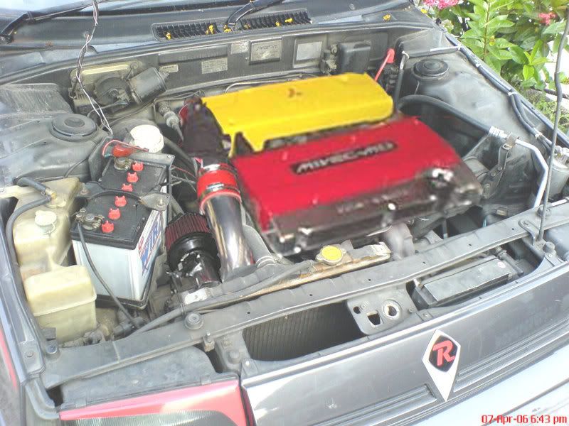

u need to mod mounting for 4g9x into saga/iswara...
if not mistaken...need to mod 1 mounting.....

tq, rear disc brake sure must mix lo, drum always make the noise, i only afraid is whn install not suit to the chassis, cause the weight too light, thn jpj don pass it, haha...
you need to adjust 3 mountings except the gearbox to fit in 4G9x into a saga/iswara.
unless you want to use back the stupid half row radiator and the stupid air con condenser, then only 1 mod to the timing belt mounting is needed.

Just want to share you all guys about this photo. This photo took from last year mid of oct. It's one of my friends car.
