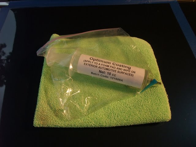

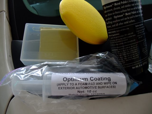

I received a sample of Optimum Opti-Coat with a shipment of Optimum products from the US.
Opti-Coat is one of the latest products to be released by Optimum Polymer Technologies. According to Optimum, Opti-Coat forms a permanent coating that acts as a second layer of clear coat that bonds to all surfaces. As the Opti-Coat will seal in any paint defects or contamination on the surface, it is only sold to professional detailers who have to sign a release form before they can purchase the Opti-Coat.
Naturally, after signing a release form and reading about how Opti-Coat forms a permanent coating that acts as a second layer of clear coat, I had to try it out for myself.
Although the Opti-Coat is supposed to provide an additional layer of protection on top of the regular clear coat, what better way to try out a product that is supposed to act as an additional layer of clear coat than on a car with clear coat failure?

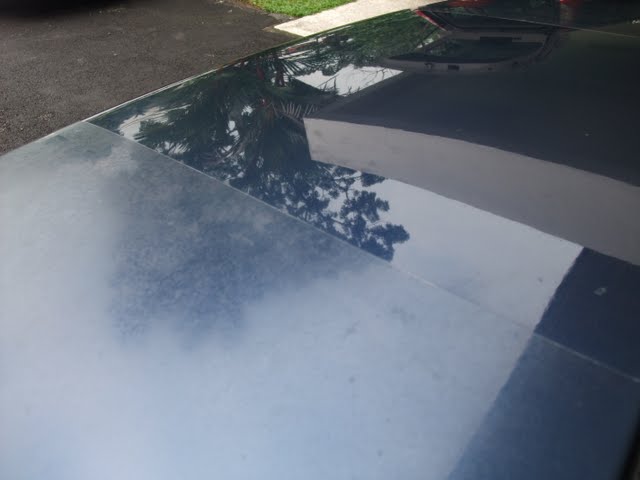

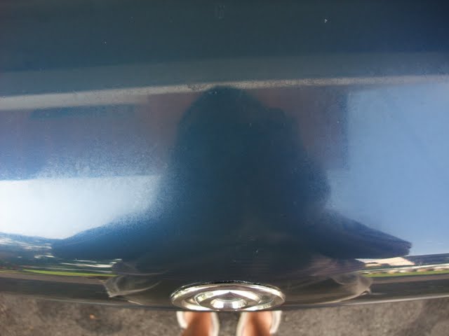

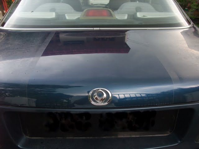

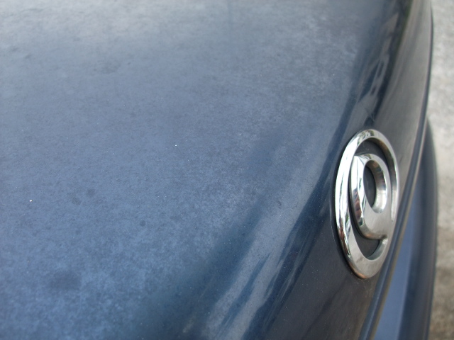

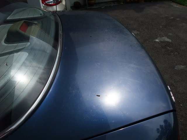

I had carried out a trial in 2009 on a Mazda 626 which suffered from clear coat failure on the trunk of the car. At that time I was evaluating the correction potential of a few Meguiar's products.

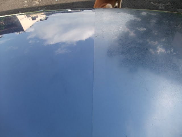

Some pictures from that trial. Before:
After:
The full details of the trial can be found here:
ProDetailing: Wetsanding+M105 vs M105 vs M86 vs M83 vs UC vs D151
Note that despite the clear coat failure as evident in the first picture, the paint defects were removed by compounding. However, this was only temporary as the paint would fade back to its original condition due to a lack of a clear coat.

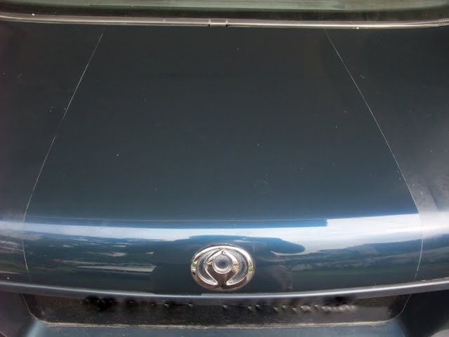

While not designed for this purpose, would the Opti-Coat be able to act as a 'new' clear coat? Only one way to find out.....
The condition of the car about a year after the initial trial.

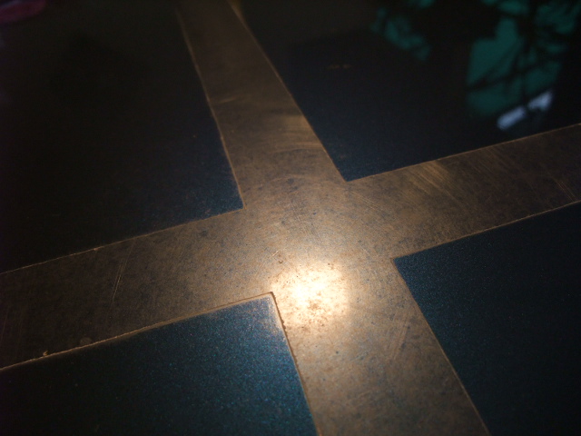

Inspired by the Porsche Design Cayman I did a couple of weeks earlier (ProDetailing: Porsche Cayman Special Edition - Optimum Detail), I decided to replicate the stripes by taping off the middle of the trunk for the trial.

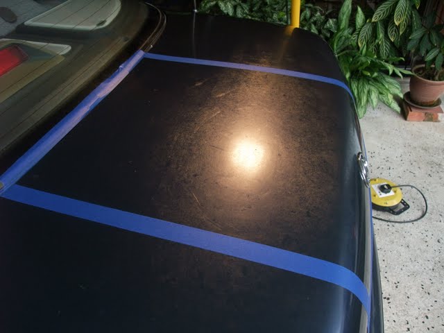

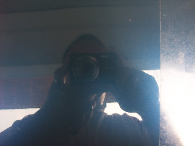

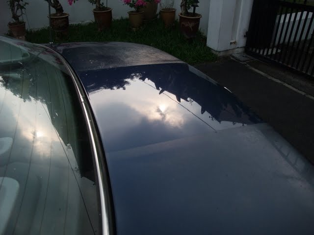

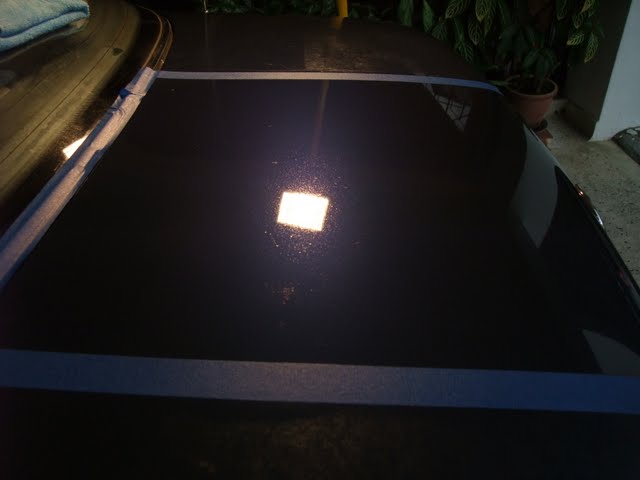

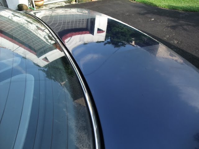

Compounded the trial area with Optimum Compound II + Meg's 2.0 Foam Cutting Pad. As the Opti-Coat will permanently seal the surface of the paint, it was critical to ensure that the surface was properly prepared so the OCII was followed up with Optimum Polish II and Optimum Finish.

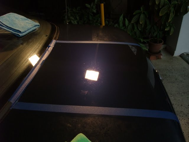

Ready for Opti-Coat:
A few drops of Opti-Coat were applied to the surface of the paint and spread with a foam applicator pad until evenly distributed. For a product which is supposed to form a permanent coating, it was surprisingly easy to apply with no mixing of parts A & B or any special application techniques. In fact, the Opti-Coat was more like a supercharged version of Opti-Seal.
The Opti-Coat dries to the touch in 30 min and fully cures in 12 hours.

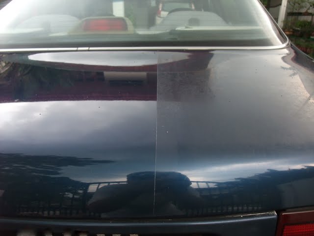

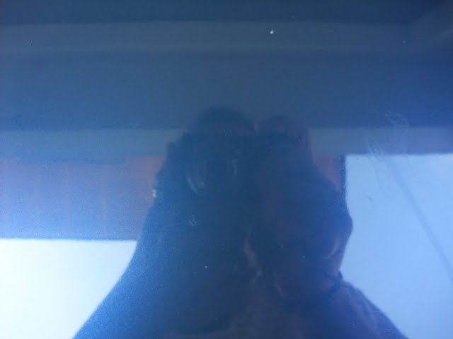

After Opti-Coat:
Can't say that there's much difference but the real test will be to see if the Opti-Coat can act as a 'new' clear coat and how long it can protect the paint.

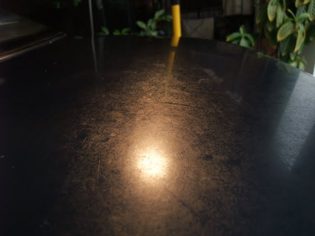

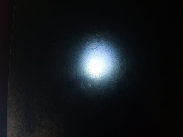

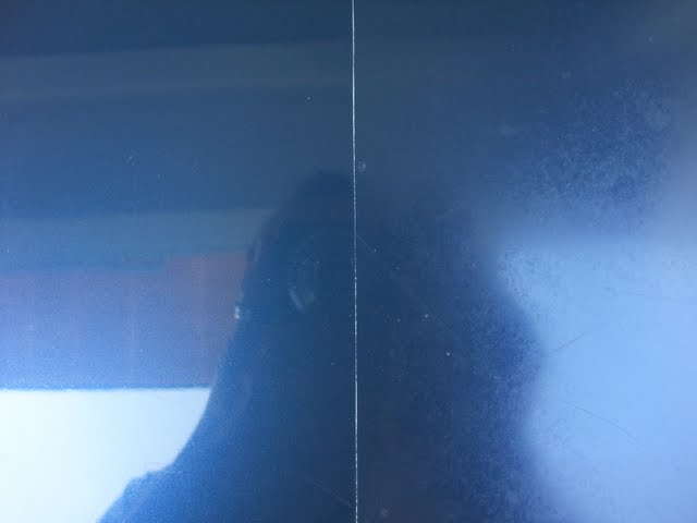

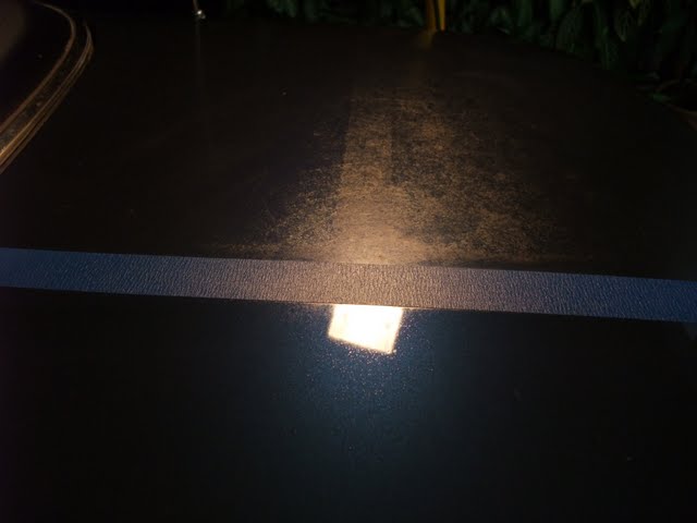

Got the LED light out for some shots. Untreated:
50/50:
After Opti-Coat:
More comparison shots:
Should have taped off one line down the middle and it would really have looked like the Porsche Design Cayman...

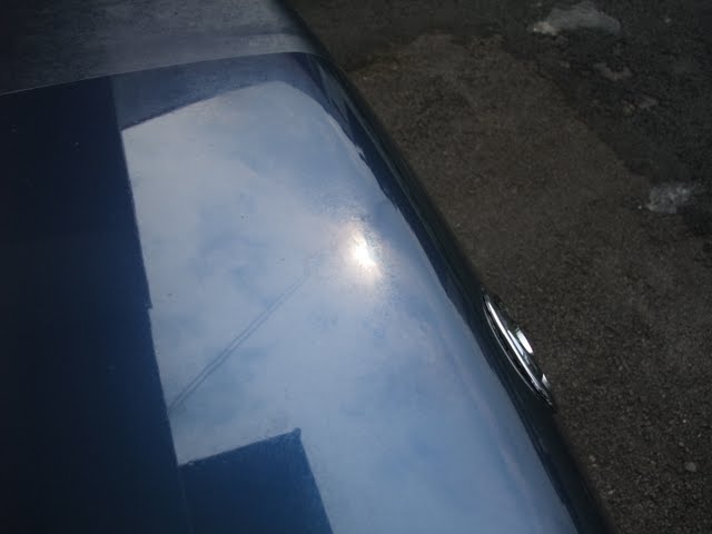

It has been two weeks since my attempt at replacing the clear coat on a clear coat failure situation with Opti-Coat. Took some pictures to monitor the progress of the Opti-Coat.
The condition of the test section after the Opti-Coat application two weeks ago.

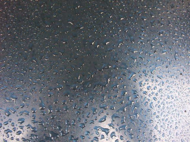

2 weeks later, after spraying the area with ONR before wiping off.

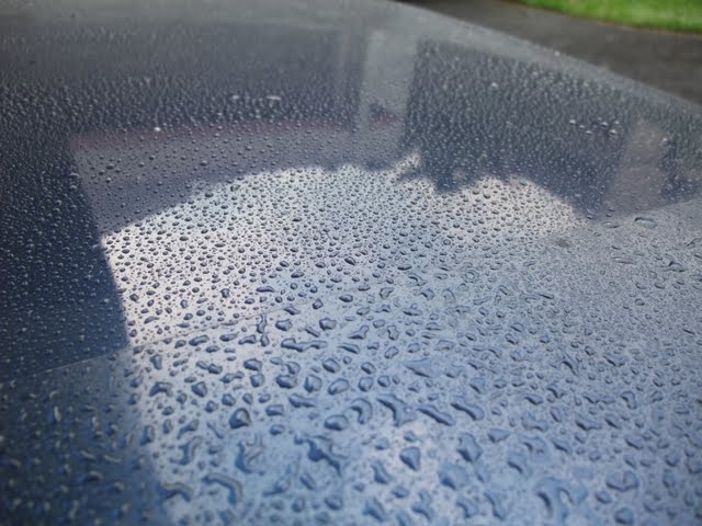

The area treated with Opti-Coat is still beading quite well.
Untreated.
Opti-Coat.
After wiping down with ONR.

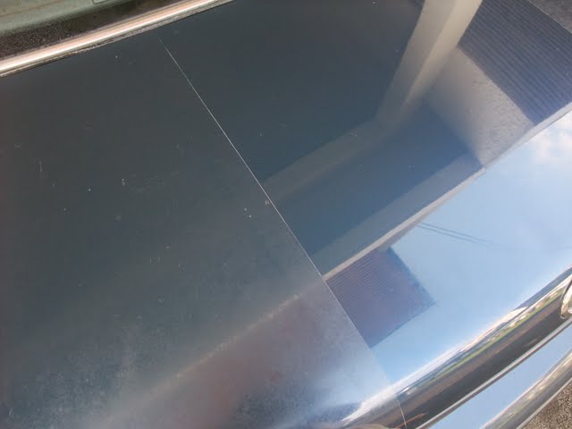

The Opti-Coat seems to be holding up well with some nice water beading and the test area still looking nice and glossy. But, there is a slight issue with a section of the test area.

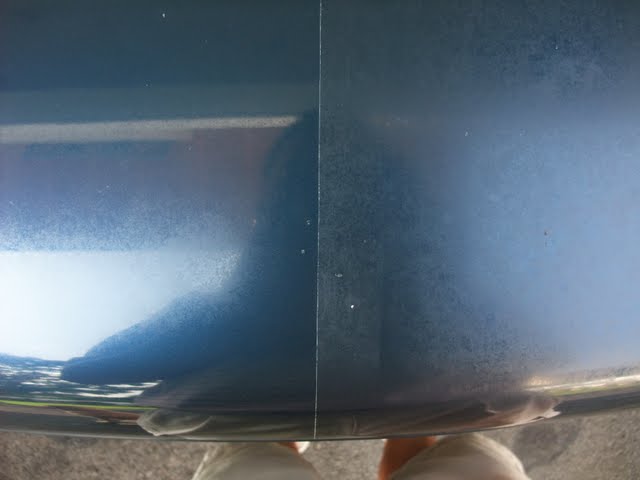

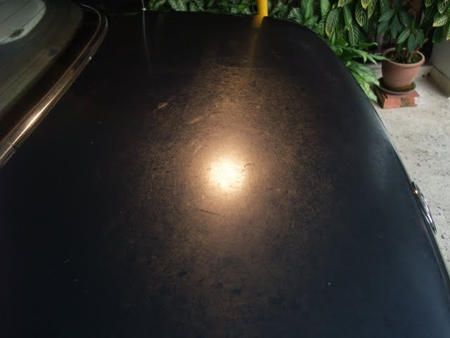

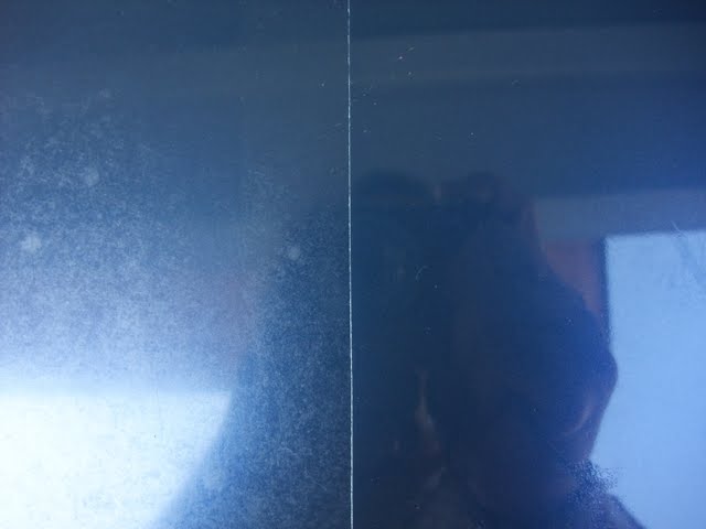

Although the entire section is still glossy and the Opti-Coat seems to be sealing in the entire test area, the paint below the Opti-Coat at the edge of the test area seems to be fading.
However, the Opti-Coat seems to be working well on the top section.
Bottom.
Top.
Observations so far, with the exception of that one section, the Opti-Coat seems to be holding up well and preventing the clear-coat failure from reappearing. As for the section which is fading again, perhaps the compounding and polishing wasn't sufficient or the Opti-Coat was not applied thick enough in that area.
It will be interesting to see if the fading continues to spread and how long the rest of the test area will lasts.

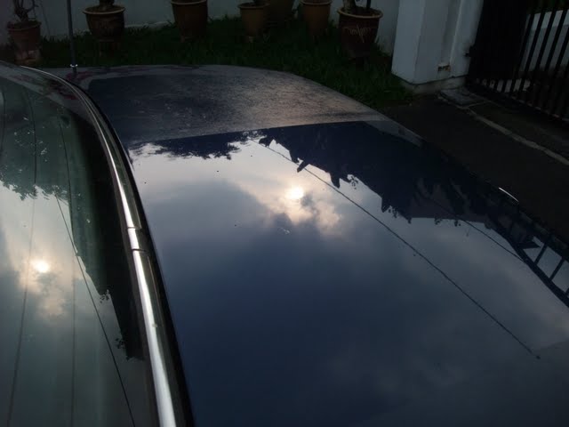

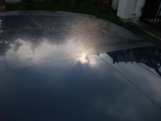

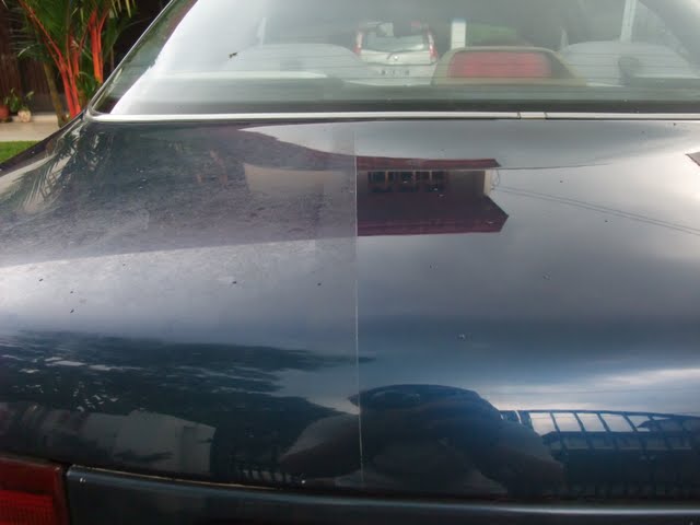

This was the state of the boot before anything was done.
This was what it looked like after compounding, polishing and an application of Optimum Opti-Coat.
After two weeks, there were some issues with the paint fading at the edge of the test area.

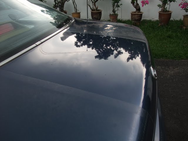

I was very keen to find out how the Opti-Coat was holding up as there was some issue of fading in the edge of the test area. As reported in the update two weeks ago, I suspect that this was due to the surface preparation as the rest of the test panel looked great. The only way to confirm this was to evaluate if the fading continue across the rest of the panel.
The Opti-Coat still looks great!!!
I was very anxious to view the results after another two weeks and after a quick ONR wipedown this was the results...
[i,g]http://lh5.ggpht.com/_KgHZeGuxwBw/TAmzRO6rwwI/AAAAAAAABcA/uQP4Blp-0WQ/s800/2010_06050047.JPG[/img]
If you compare this with two weeks ago, the faded areas still look the same.
How about the rest of the panel?
/lh6.ggpht.com/_KgHZeGuxwBw/TAmzSX0vuAI/AAAAAAAABcQ/7d5RqCbcevE/s800/2010_06050050.JPG[/img]
Still looking pretty good...
Conclusion:
The Optimum Opti-Coat really does work. Although this was never meant to be its intended purpose, I could think of no better way to test what is supposed to be a second-layer of coating on a car which had clear coat failure.

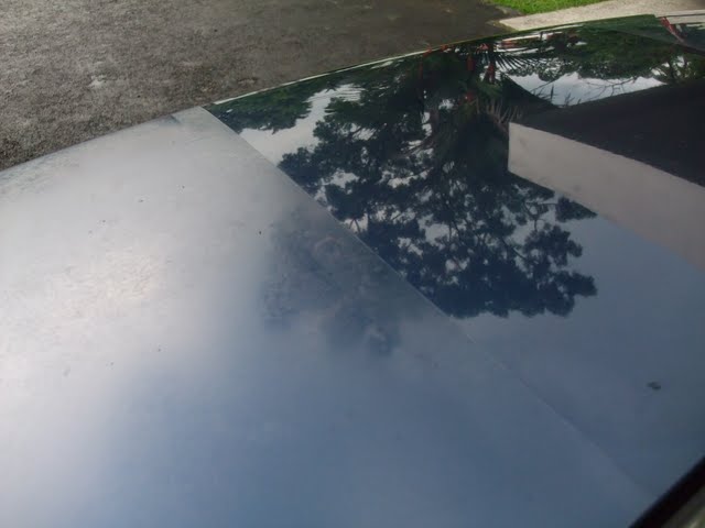

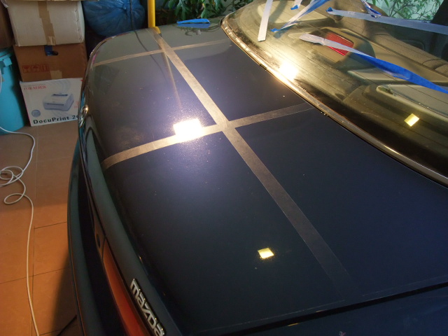

The surface of this test vehicle suffered from clearcoat failure. IF the Optimum Opti-Coat really works and forms an additional permanent protective layer on top of the paint, the coated area should remain the same and the paint should not oxidize and revert back to the original condition over time.
Early-May 2010: A section of the test area was taped off and corrected before the Optimum Opti-Coat was applied.
After correction. Nice and shiny with the gloss restored.
Time to try out the coating...
The surface really looks great!!!
Mid-May 2010: Great water beading!!!

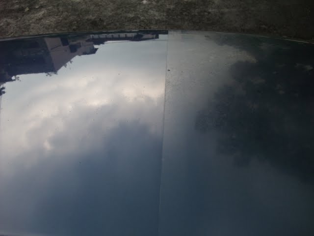

Is it permanent? I can say with certainty that it most certainly still appears to be permanent after 2 years!
The coating was applied on around May 2010 and it is now nearly 2 years since the coating was first applied. This was the condition of the paint with definite symptoms of clear coat failure.
After correction and application of Optimum OptiCoat.

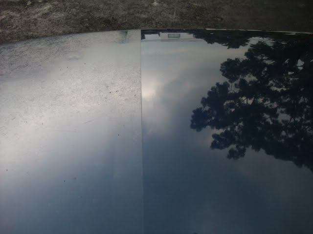

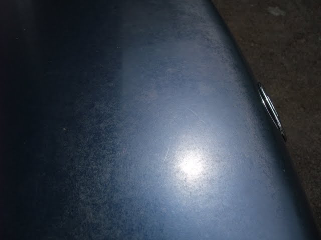

Fast forward 2 years later...
The side without Optimum OptiCoat is definitely suffering from clear coat failure!
The OptiCoated side is still in good condition without any signs of oxidization or clear coat failure returning but there are now swirls in the coating from improper washing.

All done! Testing the reflection with a bottle of detailien alien wax!
http://4.bp.blogspot.com/--2Hzka1xnnU/T4Z2578zopI/AAAAAAAADxg/4fqdRa--sTg/s640/DSCF7754.JPG
http://2.bp.blogspot.com/-0MJqb_JAwBI/T4Z272nzu3I/AAAAAAAADxo/bEtVmc1J-iA/s640/DSCF7752.JPG
I think this picture says it all....

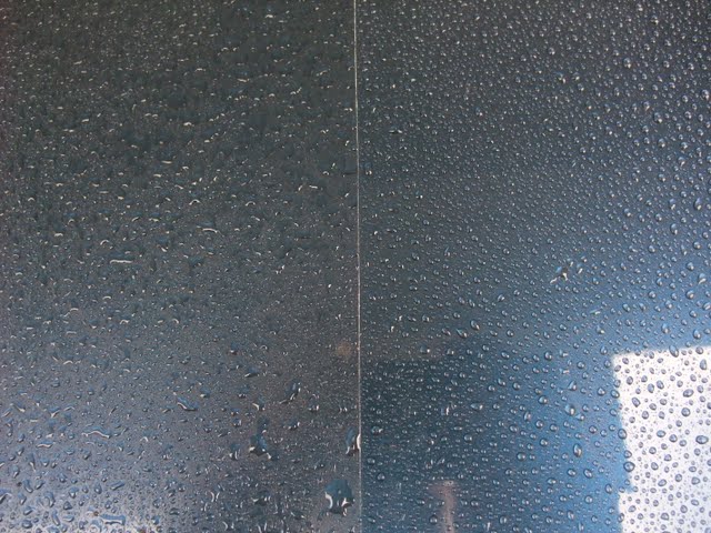

Test of water beading.
How about some full sun shots?
Lovely color and definition to the area protected by Optimum OptiCoat.
