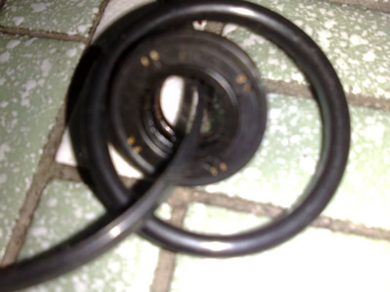

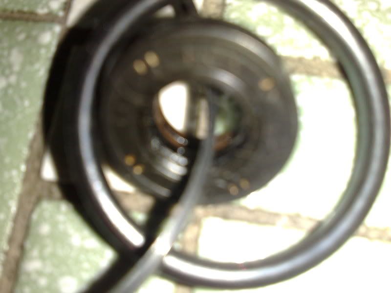

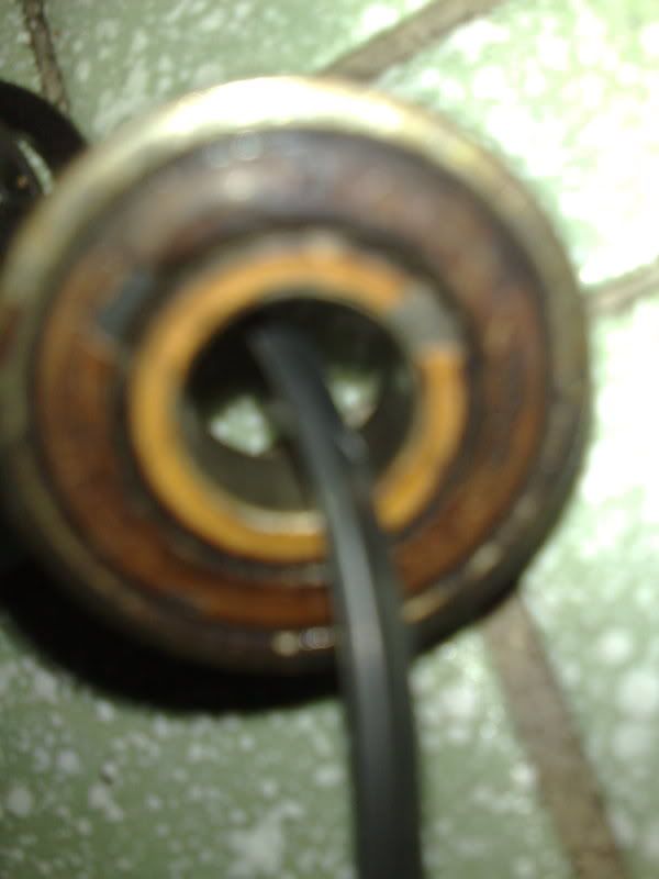

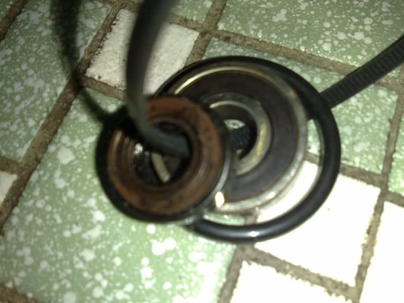

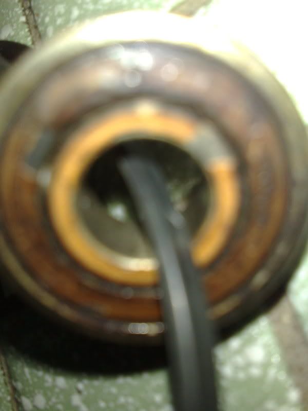

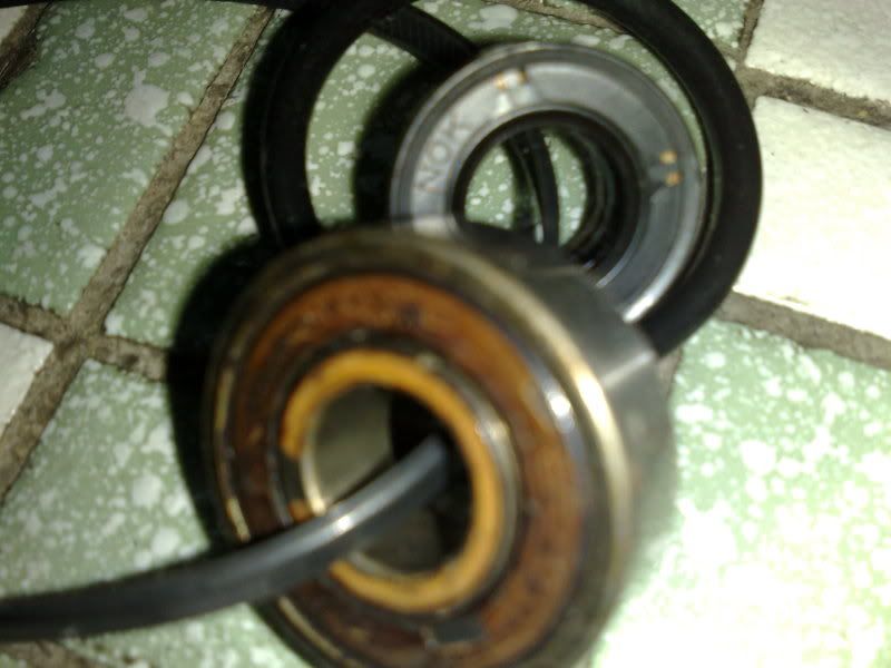

Updating : Change this three rascals and the leak will stop! (minus the cable/wire tie ok)
Looks like a bearing, a spring loaded oil seal and a O ring. So changing these 3 stuffs would solve the problem eh?
yup...
the inside oil seal...is the culprit...
