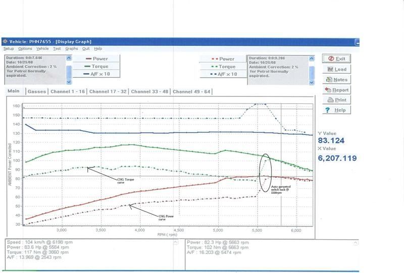

Generally, Natural Gas works better under higher compression N/A engine. In fact, a study shows the Natural Gas works the best under the 16:1 comp ratio.
When people says the power loss in our normal petrol engine when running on it, its all due to the relatively low comp ratio for Natural Gas combustion.
This is a sample of how a typical n/a engine would work under gas. Dynoed the car in Links sunway though. However, the judgement of the graph itself cant justify the normal driving condition as it was carried out under 3rd gear and FULL throttle. generally, we should have much better curve in part throttle.

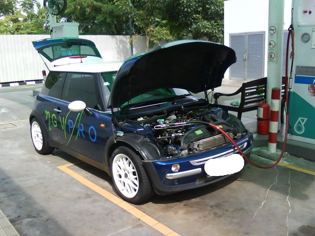

after observing so many NGVs on the road for so long, this CNG powered Mini Cooper is definitely 1 of a kind.
the owner told me the cars is fitted with a sequential system, the mileage is only RM 0.06 per km, runs extremely smooth and powerful, power loss is almost negligible. i can see from the engine bay the installation work are also neatly done - especially on this compact and tight engine bay.
