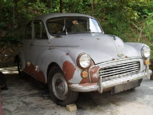

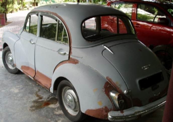

I want to refurbish one Morris Minor and seems that the body is indentical to VW I just wonder where can I do the welding , change all the windows/door rubber and paint.
No major welding needed... just few small holes here n there...:_:
I also wonder where can I get cheap parts... not for the engine but for the body.
Your information n help is well appreciated.
Thanks.

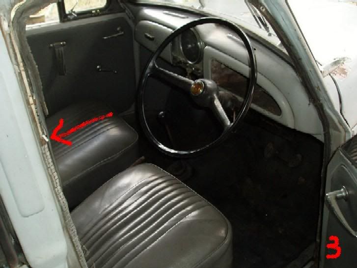

Here are the pictures of the car....
I just want to know if the rubber at the door have an universal replacement.

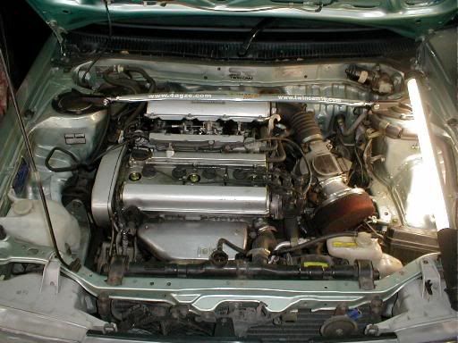

Here are some info I gather from the net.
Toyota 4A-GE
If you're looking for high-revving POWER in your Minor then this must be one of the best available options. The engines come from the rear-wheel-drive versions of the Toyota Corolla range, ****** from about 1983 to about 1988. The engine fits surprisingly well into the Minor engine bay. It's almost exactly the same length as the Datsun 1200, maybe even a little shorter (the ancillaries like water pump and fan blades stick out less).
The 4A-GE puts out around 110bhp in standard form, so if you follow this path you should expect to have to change the rear axle, and obviously the brakes all 'round. The poor old Minor diff just wont take the power and the front drums are hopelessly inadequate for slowing a car rapidly down from a possible top speed of around 130mph/200kph !
Even MORE Power!
The Toyota MR2. Toyota's mass produced 'Sports' car. 1600cc Twin Cam. 130bhp in standard form. Plenty you say? Want more? SUPERCHARGE IT!
The 4A-GE is also available in Supercharged form, as in the 4A-GZE, as fitted to the MR2. Fit one of these babies into a Minor and you'll have one awesome piece of machinery! I have yet to see one in-the-steel, but I'm sure one can't be far away. The 4A-GZE puts out around 150-160bhp. These engines also perform well if converted to use 'Old-Style' carburetors. An Off-Roading friend of mine removed ALL of the electronics and fuel injection, made up a casting to accept a Holley 350 carburetor, fitted a smaller supercharger pulley and locked it in place so that it operates at all engine revs giving about 15 pounds boost at all times! Driving through a VW gearbox (the engine sits in the back of the Off-Roader) it dynoed at 160bhp AT THE WHEELS!
