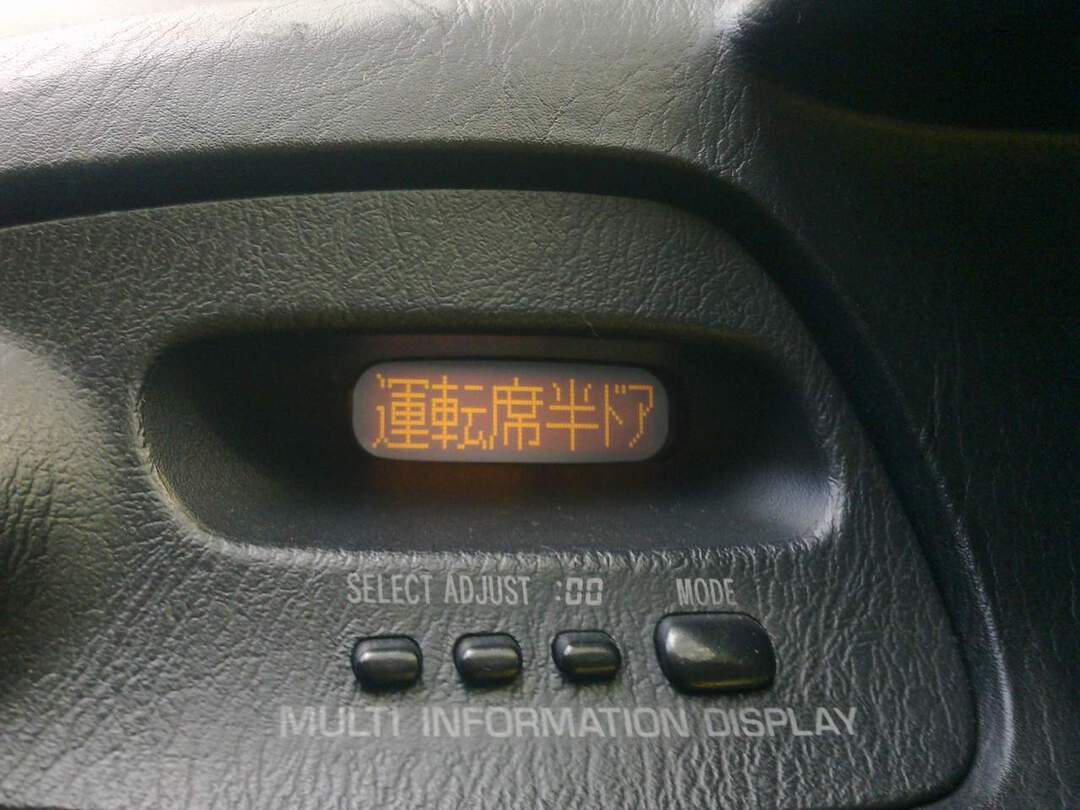

I have a few problems on my car right now which I don't know whether it is related or not. So I am listing it here.
1.There is an error shown on the multi information display. I can't read japanese, so I hope anyone can explain to me what it says.
