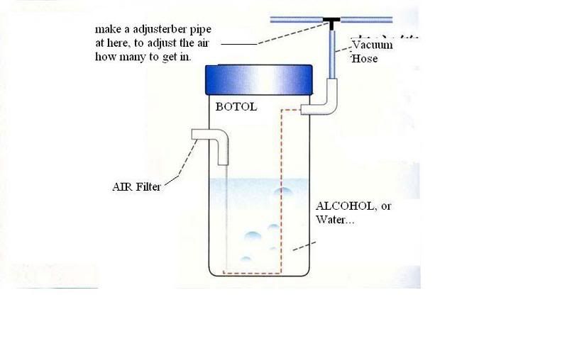

something like this??..
http://i61.photobucket.com/albums/h73/kahchai/diywaterinjection.jpg
http://i61.photobucket.com/albums/h73/kahchai/diywaterinjection1.jpg
http://i61.photobucket.com/albums/h73/kahchai/diywaterinjection2.jpg

erm... explain in words vr hard ler... u need to first understand the basic understanding how this stuff works....
anyway, things u need:
- good quality water bottle
- aquarium hose / vacuum hose
- breather
- T-connector
first, build the bottle like this...
another sample...

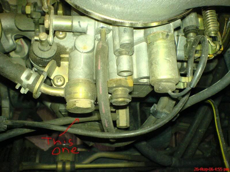

after that, find any vacuum hose that is connected to ur intake manifold... if u driving proton with standard carburettor, tap to this hose...
from the diagram its look like suck cool air from the bottle.. not water...
as i know, we want to suck the water flow into the intake manifold.
it is sucking moist from the bottle... not jz air...
u need a mist spray mounted at the manifold if u want it to suck water directly...
this is not a perfect diy as water is not injected as fine mist into the TB... thats why instead of sucking water directly, we suck moist in the bottle...
if EFI i guess u need a water pump, which gonna cost abit more... coz fuel injected engines dont have vacuum pressure inside the manifold rite??... correct me if wrong... coz previously ftzone do sell such water injection system... his package for EFi engines includes a water pump......
