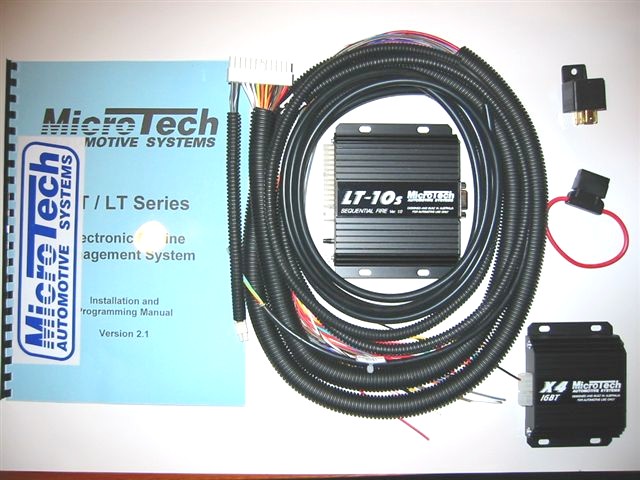

microtech is proven in perfomance and managements....
