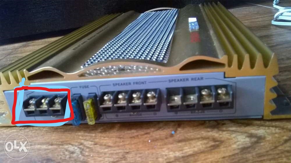

well its already done by make new hole...now im wondering about to install preamp... can i loop power from power amp to pre amp?? or do i need new cable..please refer to picture
Pre-amp? Modern head units with high pre-outs won’t need preamps anymore.
Biggest bang for buck is a mono amp plus a subwoofer.
You can but why would you need to? You don't need a pre-amp la. Those are most of the time a waste of money.
yea i know ..HU already got good equlizer..but my setup is dash board and rear door speaker direct from HU. while my boot shelf speaker powered by power amp for only bass out..so if i setting bass from HU then my dashboard and rear door also play bass which cause distortion something like that...
what i want to do here is.. i want install pre amp only for my boot shelf speaker ( which is only bass) for allow certain bass band frequency only.. so i think it will be more clean bass from the back..furthermore i can turn off bass from HU EQ..so my rear door and dash board speaker will play only midrange to lowest mid range frequency...how about that master..tell me which part im wrong here include guidance..

one more thing guys..i believe u guys though i had Good HU such as kenwood pioneer,,, JVC etc... that have good Equalizer build ...well im not..
im using android double din from china which is using cheap audio Chip build..thats why im thinking i need that Pre amp to make more clean sound..well im NOT fan of boom boom bomm bass...i want to hear everything from highest to lowest frequency. maybe i need extra bucks..so i try to figure it out from here.,..what suppose i do

Wow.. you have a weird setup. You should set it up to all run off the amp. HU output is usually very very lower power output, so you're barely making the front speakers work properly.
Anyway, personally I'd just re-wire and clean up the setup.
HU--> amp --> front speakers + rear speakers (assuming your amp is 4 channel).
If not 4 channel then : HU--> Amp--> front speakers. Rear speakers connected to HU then adjust fader to front speakers

yes this totally what i do! but when u increase bass on HU EQ its will push bass at ur front component also right!? and u said front component without amp..its will sound pretty irritating right?

my amp only 2 channels.. so it worth less to drive rear door speaker while im using the amp only for bass output on the shelf..and front speaker is 4" which doesnt need high power at all..its not weird im afraid..because front speaker loud than other speaker without using amp! here i hate to to turn on bass at HU EQ which cause stupid sound on my rear door and dashboard speaker why i need those bass if already got all bass from boot shelf speaker..am i right masta?...
