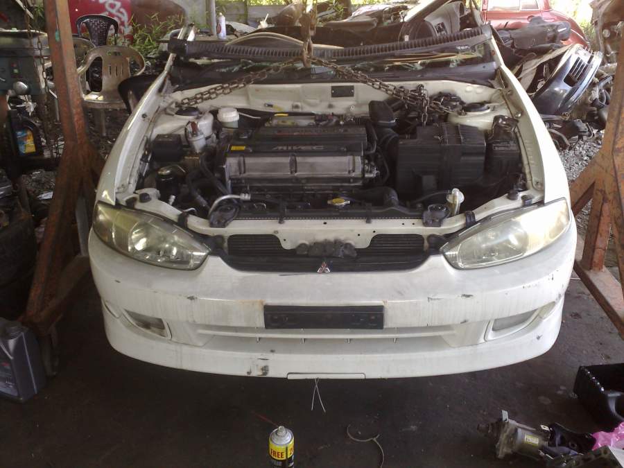

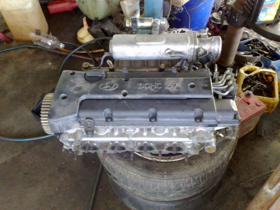

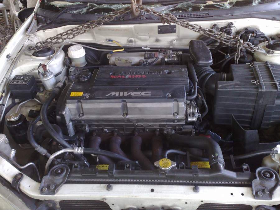

Hi all. My old heart gave way last week:bawling:. Guess its time for a heart transplant:nurse:. After much consideration, this is my new heart. All usable parts from old hearts are available for sale to cover the cost of transplanting new heart:biggrin:. I`m trying to change the face & Also the dashboard as well.

Mivec woh! how much the 1/2 cut?
I think the Mivec is 1.6cc right?
get more photo during work shop ya!

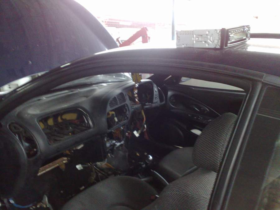

Half cut cost me rm6800 & it is 1.6 :proud:. Dashboard in already. Some modification needed to be done. Door trim have to be cut & rewrap to cater for the dashboard. Will keep you guys update with the progress.:biggrin:
wah...coupe with mirage (mivec from mirage rite?) dashboard..this i must see...

as far as i know mivec 1.8 dont exist..what they call mivec1.8 is the 4g93p(satria gti engine) with the mivec head from the 1.6 and the wiring.. so u need to check out the 4g93p engine mounting..

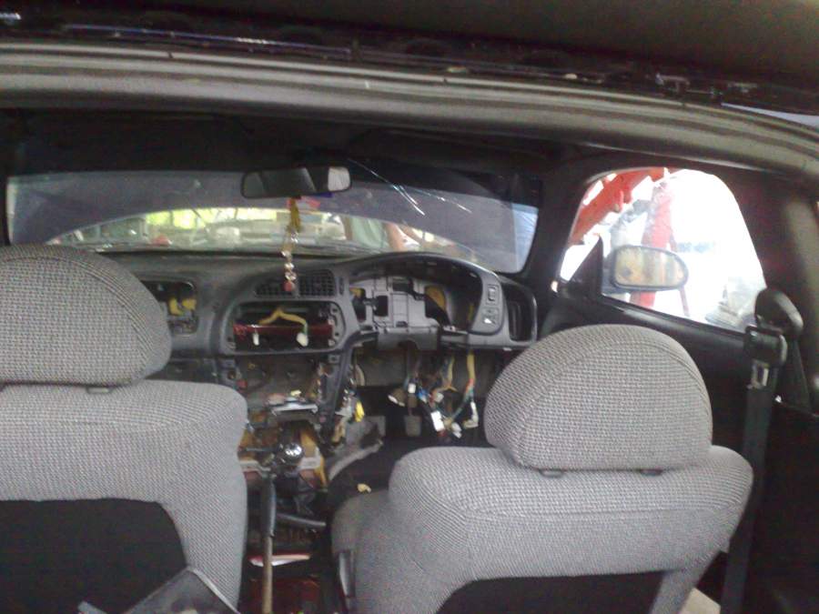

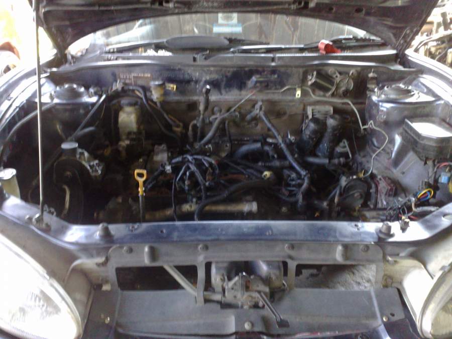

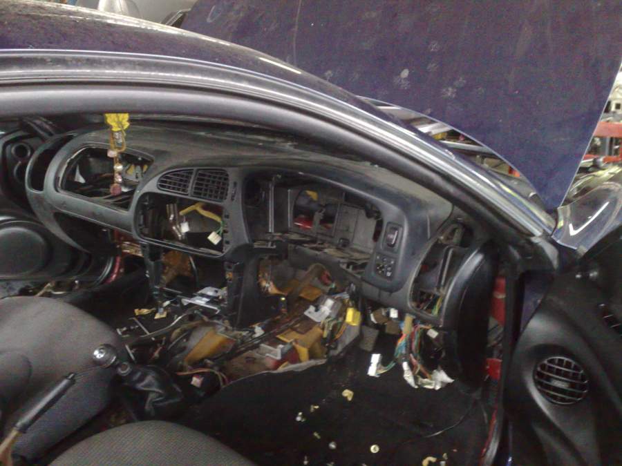

After so much measurement and adjustment, sad to say that the dashboard cant be fitted :banghead:. Steering column and blower position is the hardest part to align. So, now just the engine and front body parts perhaps.

don't be sad, the ori dashboard is better looking, haha...

the 4 engine mounting need to be mod I think, n the drive sharf too, n so on.....
