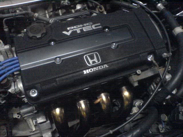

Before Pics :
http://img404.imageshack.us/img404/8086/cimg4193sk3.jpg
During DIY :
http://img264.imageshack.us/img264/4823/cimg4203zn7.jpg
After completed :
http://img227.imageshack.us/img227/2567/cimg4241lu0.jpg
After Pasang :
http://img513.imageshack.us/img513/978/cimg4243ec3.jpg
After 2 Rempit 1st-2nd Gear :
http://img474.imageshack.us/img474/7804/cimg4244xc4.jpg
Extractor : rm1200
Drill and Wire Brush + sand paper + Miscellaneous : rm170
Satisfaction : Priceless :regular_smile:

A special Thanks to Mr Shiroitenshi for the great DIY guide, Ah heng exoz in usj 1 for lending me their machine to polish for free and to my GF who help me sandpaper the header AHAHAH!!

hehehh it was Diy-ed myself....juz wanted something diff......not the usual blackredyellowblue colour......
but it was a rushed job so i didnt sand it properly - _ -
rm170 was including the bosch drill....tat alone was rm150......and my legs sexy marr hahahhaha!
Haha.. rush work or no rush work, it's a good job for a first try..
My first try took me 3 months.. lol.. I used sandpaper all the way, no wire brush/grinder/etc.
Then again.. it paid off really well.

i used wire brush at first.....no matter how much effort i put in i just couldn't get rid of the oxidation spots on the top part.....the drill not enuff rpm lol.....hence went to ah heng to do.....it got shiny in a mere 30 minutes......gave it a polished effect.....

The drill is only for the parts like the welds, or the badges. The angle grinder does it quicker for the flat surfaces.

nice clean header you got there..
what grid of sand paper u use?
320grit dry and wet for the more stuborn stains, then progress from 800 - 1000 - 1200 grit for the mirror finishing.
But since then I've learnt to do it faster. The DIY I posted in the ZTH thread weeks or months ago shows the second or third unit unit I did (third if inclusive of mine).
Angle grinder for the first up stain removal, then the 800 - 1000- 1200 grit sandpaper for the mirror finishing.
Nice headers.. sweet color after the rempit :)
Any step by steps on the polishing process? heheh..
You missed it.. I did a diy writeup about it a while back.
How to Polish Your Manifold
Anyway, currently they look different than the picture though, although they still retain the mirror finish.
My high EGT temps made them super bluish now... I thought it was oil, but someone on HT said it's due to high EGTs.

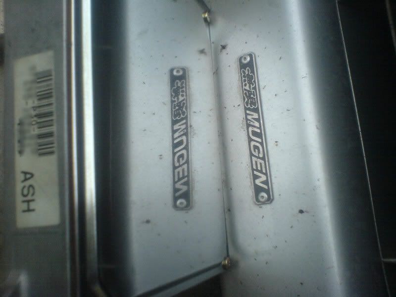

And if you're slightly not right in the head like me.. sometime you see impractical applications like on the ECU case which is hidden from sight.. LOL!
