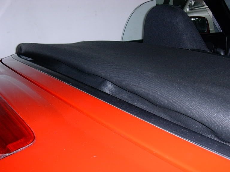

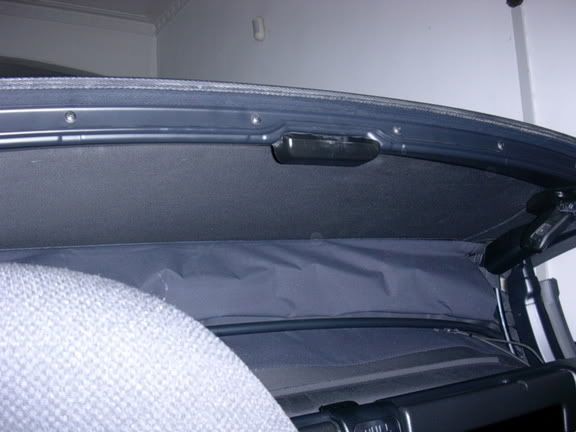

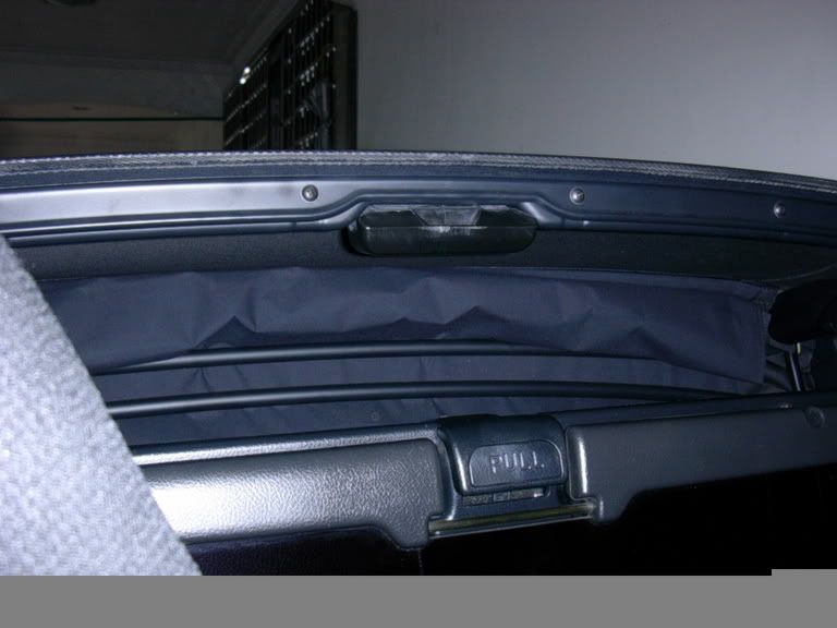

i think my soft top hav some problem also ~~
cannot close it smoothly ~~
i need to close it outside the car ~~ becos if i close it inside the soft top jus close half way ~~ strange ~~ other ppl can close inside the car ~~
jus like 3pics below ~~
sometime close like tis onli ~~
sometime like tis ~~
if i close it outside the car ~~ i need to push the roof in ~~
but the roof will pop up ~~
HEADACHE ~~
how to solve ? add some oil ?
your flaps (on the sides ) are showing cause the 'belt' that 'pulls' the rear 'ears' is unbolted. And this coupled with some uneven tangles.
There is a 'loose' belt that came unbutton under your soft top. That belt is suppose to pull the soft top in place when you go top down. it is actually a simple remedy. Many owners didn't realise this. This 'solution' can be found on spyderchat . do a search.
