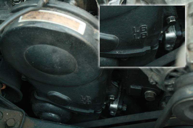

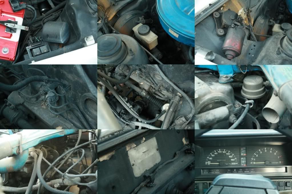

I don't know my engine spec, hope someone here can tell from these pictures.

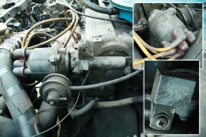

It appears to him that the Distributor is not supplying electric power to the cables.
So he dismantled it and cleaned it with WD40 and sand paper. After that, it is back to normal.
The problem gone for a long time (few months) until recently it came back. This time I told my dad what the mechanic do for a temporary solution and he did clean the distributor. But I'm not lucky this time. This method doesn't work anymore.

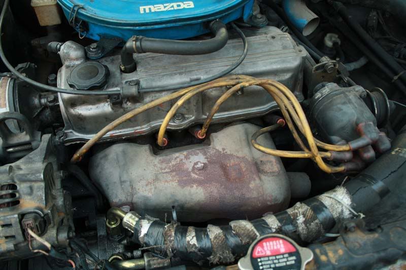

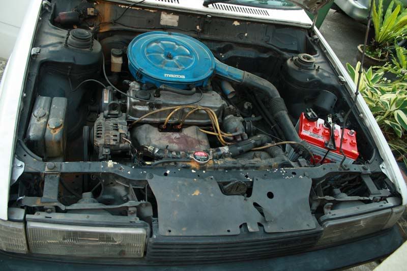

Some more pics:

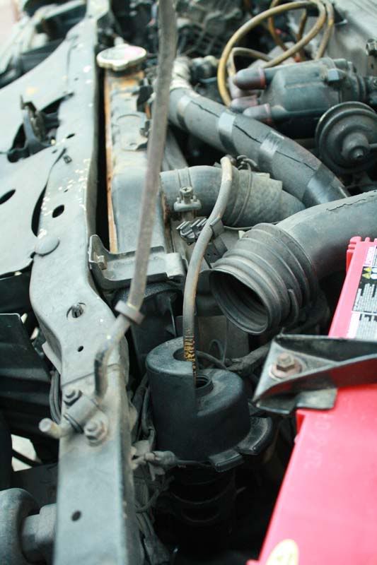

Could it be this?
What are these??:confused: RPM meter not working:bawling:
