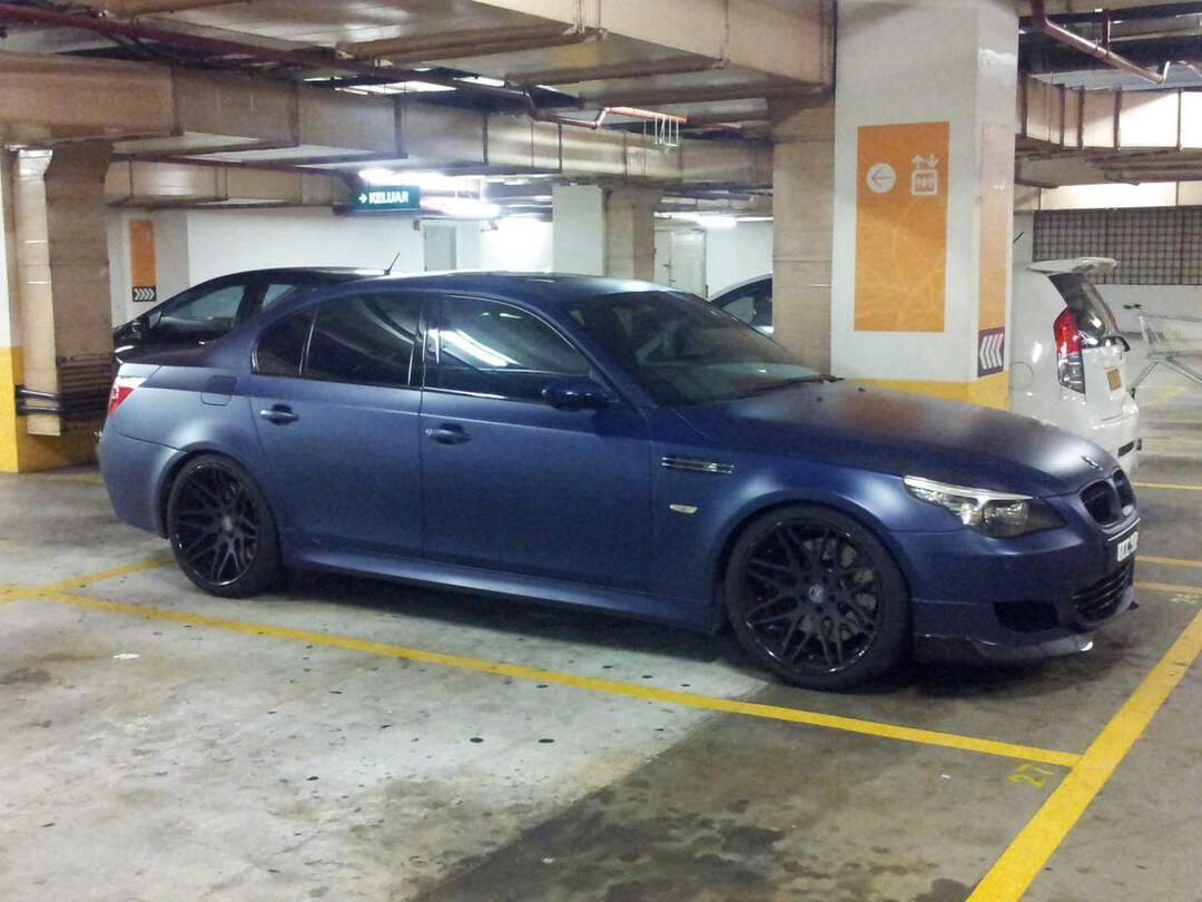

Both a good friend and I both have matte paint cars and we both wash cars at the petrol station down the road. Costs RM9 if you don't want them to vacuum inside. I wash mine once a month, my friend probably at most a couple times more than I do. Definitely I'm not a potential client for auto detailers haha.
My advice - Go ahead with paint job if its an important aspect of the project car in order to complete the look.

Thank you KC and Fishbonez. I think many of us can benefit from this as most don't know about matt paint.
Haha Pimpin... U are hardcore power guy mah... Engine matters!
