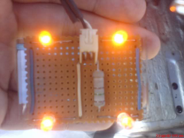

Hmm.. I have a sample, but only for four LEDs..
If you add more, the same, just wire another resistor for another four.

Here's my first attempt when doing LED lights.. This was the inital experiment I did to test out what I've learnt. The required resistance can be read off the photo, so you can calculate how much amperage I'm giving the four LEDs. I also did a socket, so I can replace it with a better made version when I have the time, but it's been like half a year, and I've still not gotten around to it.

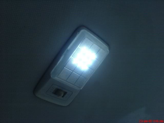

This is my second attempt, and a much better one, this one wired with 16 leds. looks OEM right? wait till you open the case!wires are haphazard oh! I used the same parts as above, except the numbers are quadrupled for the parts. The same circuit, but arranged differently to accomodate 16 LEDs.
Of note though, is that I've seen a 9 LED unit sold at accessory shops, and costs about 20-30bucks each.. I made these with a cost of less than 20 bucks. Remember to use SUPERBRIGHT leds.. some electronic shops claimed that theirs is superbright, but the brightness will be very different from REAL superbright LEDS. They're usually slightly more expensive than normal LEDs, but it's still sort of trial and error thing as well so buy, a few from various shops if you think you're not getting enough brightness out of the current leds you bought.. once you find a shop that has them though, you can buy a bunch for your project.
You can run slightly less resistance for more brightness, but the LEDs will run hot and have a shorter lifespan. Exactly how much is hard to say, since LEDs practically have burn times that probably longer than your lifespan if it's run with the proper resistance and voltage source.

But from your info, 4 LEDs : 1 resistor eh?

You can run a single resistor for two LEDs, even one.. but the ohm rating will be different.
If you're thinking.. hey! It's 12V right, so if I run four LEDs in series, I'd need no resistors! No.. it doesn't work that way.
LEDs do not have brightness control. They are either very dim, or bright, or brighter (overvolt) till discolouration occures. The problem with the brightness is that it's very different when it's in the state of not enough power, just enough power, and too much power. You can try plugging 2V and 3V, and then 6V into a white LED and you'll know what I mean. You might burn one with 6V, but that's the price of education.. :P
Could you please advise in the Room Light Circuitm& Picture of the Unit.
Cun le..:angel_smile::angel_smile:
I am thinking of making it.
It's the same as circuit in the first picture, except that there are four times the amounts of parts used, because I'm running a total of four of that circuits in parallel and I basically wired them tightly.. so even if I give you the picture, you won't see how to do it There's just a bunch of solder points on the rear of the board, and since it's not a printed PCB, you won't see where the connections are....
If you have a friend who's more versed in soldering and electronics, just show him picture one, then picture two, and he should have a very clear idea what he needs to do. The picture one IS THE CIRCUIT SAMPLE.. that's why the wires are done neatly and can be seen easily.
Sorry I don't have time to do a full tutorial.. I'll try to find time, but cannot promise anything.
If you cannot understand from the first pic.. then maybe you should buy a ready made one at accessory shop.. then just solder the wires to the switches on the ceiling light... less hassle.. 20-30 bucks, but save time oh!

ANDY PANG said:
Thanks for the advise . Please advise where can I get the Ready made you said?
Go jalan jalan at various accessory shop, and print out the photo I posted here.. they should have an idea what you want.
