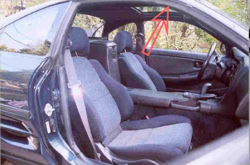

It rained exceptionally heavy today and normally, my roof won't leak so much, only maybe a drop or two from the joint nearer the front. But today, it literally poured water into the cabin. The leak was from the join nearer the rear and i did not even open the door.

it's always happen at here:

Water leaking especially where Khoo198 pointed out is common.
2 main reasons are due to misallignment of the heavy door over time and poor maintenance of rubber lining.
To remedy the 2 problems above:
1. try reinstalling the door so that it is in proper position and;
2. maintenance of rubber lining with diver's grease or of similar properties on a clean surface frequently is encouraged.
It would be a pity to seal permanently with silicone of some sort.
