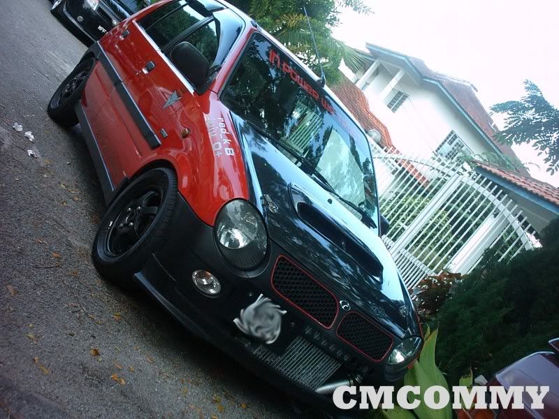

well,if u like the subaru scoop..and ur kancil is the bug eyed one,try getting just the subaru scoop,and chopping ur current hood and weld on the subaru scoop..quite yummy i should say...i will try to upload a pic or two.

that's the scooby scoop.not sure if that's the ori one or a fiber one..its about that kinda shape.so sorry for the late reply!! banyak bzzz..!hehehhe!
ala,ezoz pun illegal mah mag! hahahahahahahaahah!air filter pun tarak legal..haha!haha!
