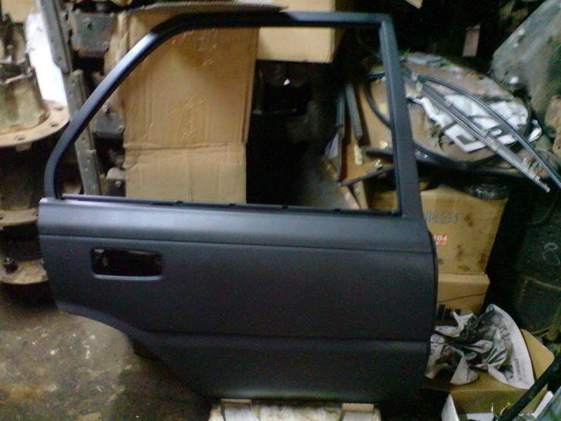

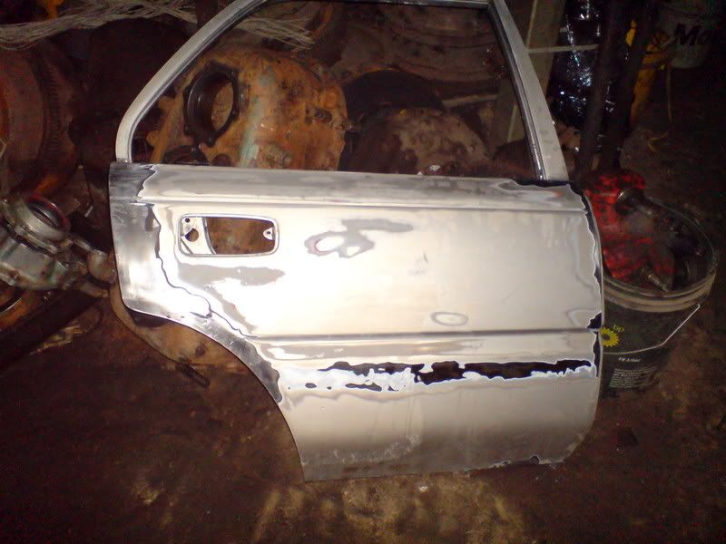

i oledi removed all the thing inside the door, now oledi done all the plastic, waiting for paint only, and still dunno how to hold the plastic only...
any idea bro?
ur "plastic glass" is copy of ur ori glass window?
maybe u can use back the "railing" that hold the glass window or just put 2 "tiang" to hold the plstic glass.
one end scew to the plastic glass and the other end just stick to the bottom inside of door
yea copy the ori glass window size...
hmm... that's a good idea also, will try to kaji kaji tomorrow,
and thanks for the advice and info bro!

today done rear side painting, wait i take some pic and share it here ya.....

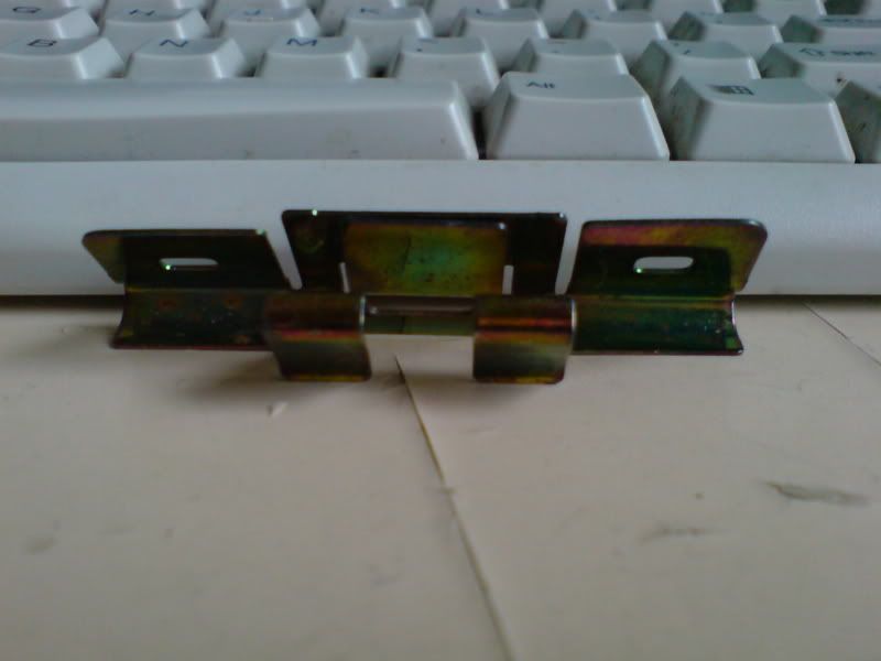

now rear door plastic i will hold it with a clip(will post the pic soon).....
update! pictures uploaded......
