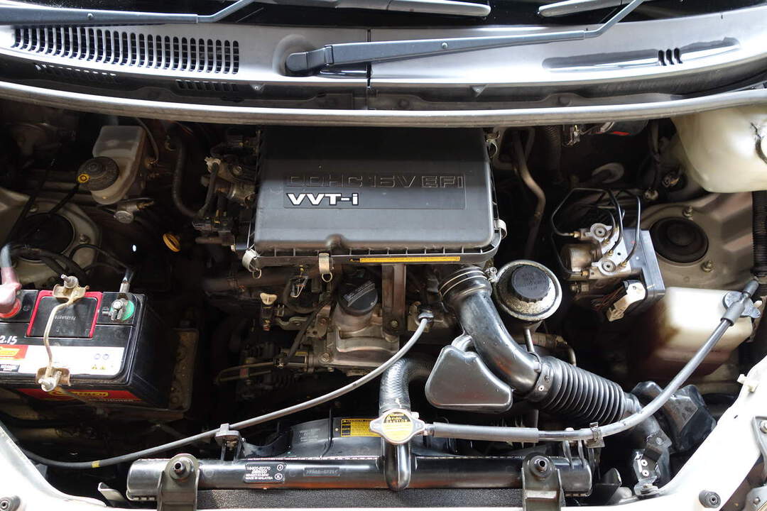

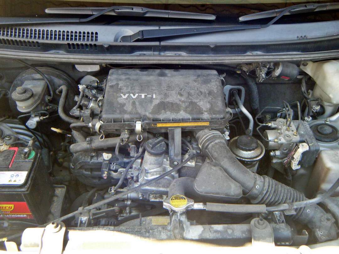

Here's a picture of my cleaning. No chemical or any special cleaning agents. Just wipe with plain water on wet cloth. 3SZ-VE on Avanza.
attachment.php
Before
attachment.php
After
