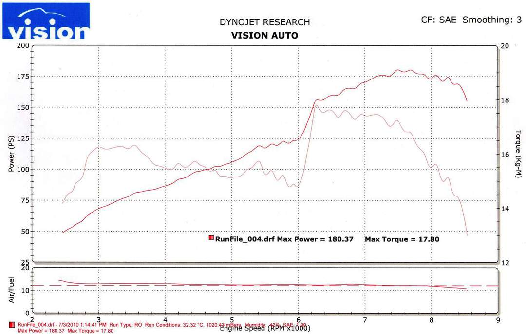

Didn't think of Dyno-ing mar.... now after the mod I feel an increase in power...of course want to dyno lorr.... :biggrin:
sent it for a dyno today...and guess what...the hondata airbox mod and K&N replacement filter DID make a difference...
180.37whp.... not too shabby... 3whp over GTi4740's stock dyno of 177whp...
mind you my car is bone stock as well... only mods = Hondata airbox mod + K&N replacement filter...
