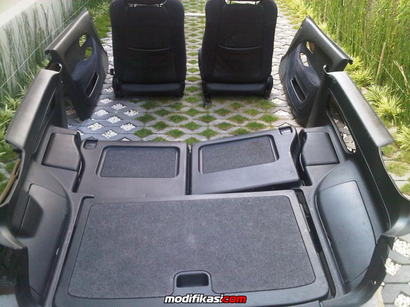

1) For a civic EH, how much does it cost to fully convert the interior into EG?
