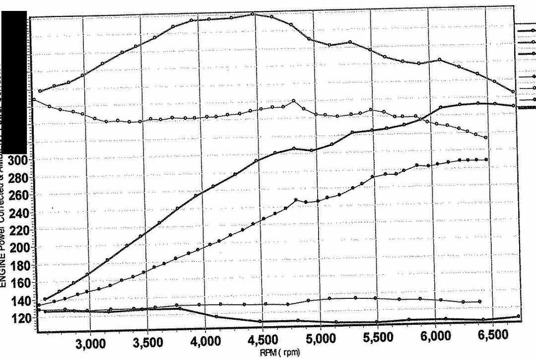

I attached 1 of my dyno result for your perusal. Bold line is after HKS SC.
