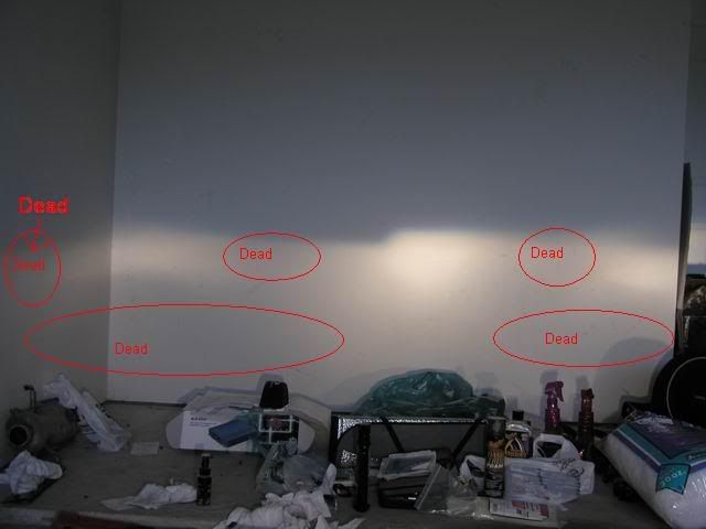

No really u just need to find a good design H1 Xenon bulb then the problem solve ...
Beam Pattern Poor H1:
A good Design H1 beam Pattern :

that is no H1 HID projector ...
After market H1 Xenon kit cost around RM 1000 .....
Original car with xenon projector will come with D2S base .....
U looking for projector or HID ???

but the 2 photos from you is actually not a fair comparison, the Poor Beam pattern photo took with surrounding light on, while the good 1 shot with other light off.

about the pic we not talking abt the brightness we tok abt the outcome....
look carefully into your H1 projector (front view) and you will see the halogen spring (the tiny wire) right in the middle that is the focusing point so if you put a slight longer bulb the focosing point will gone .....
