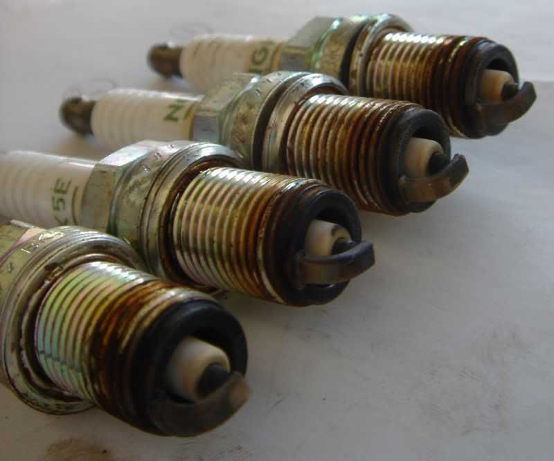

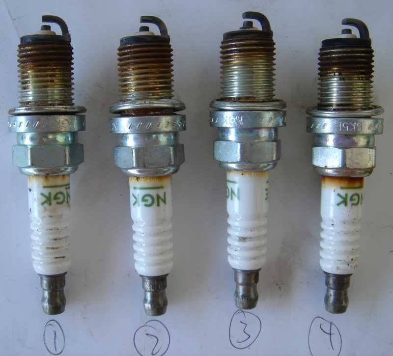

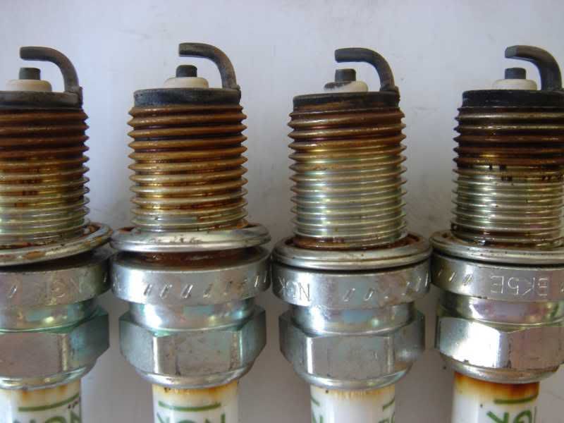

provided are pics of my current set of plugs which are the (apparently) proton original NGK BK5E. it's been used on my 4G93P putra for i think a little over 100000 km already.

From the pic, your engine seem running very lean, way too "dry"...not so good ler...

how do you know if it's too lean? do you look at the build-up of soot? and what should i do if it's too lean?

I think your plugs look fine.
When your a/f is lean, the plugs'll be whitish spots and specks.
Yours is brownish with allittle KFC chicken skin look. It look ok.
If its covered in thick layer of carbon dust, its rich.
If its sotty and oily, the piston rings or valve train have gone south.

thanks for the 1st link. mine looks normal.
