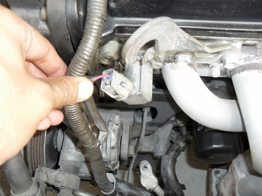

You also can try it by disconnect OCV socket to disable the VVT and observe the symptom.

Fei, plug out vvt (actually OCV) connector will not give any error code. Ecu will always give a signal to vvt but no respone from vvt and ocv assy as the connector removed.
Idle is like normal 20V coz vvt not engage while idle.
This is picture of OCV.
OCV is acronym for Oil Control Valve
