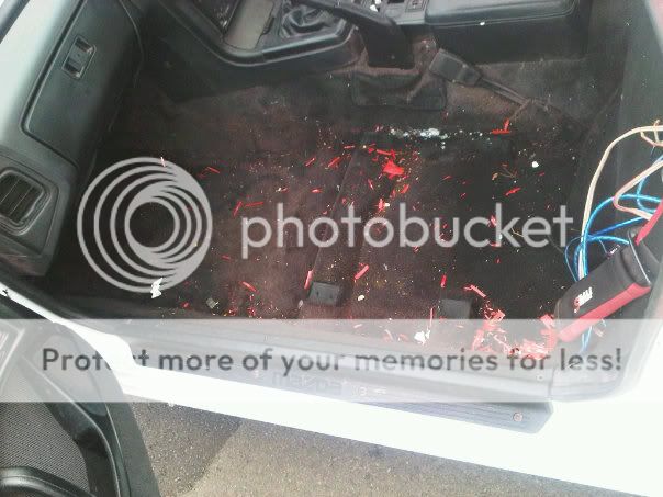

as i picked her up, dam dirty!

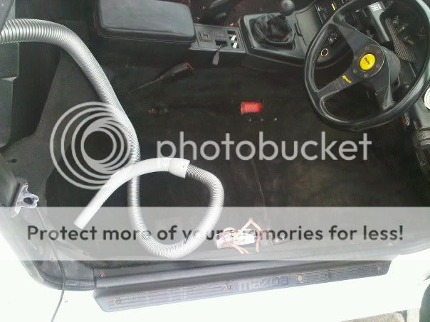

after a hoover

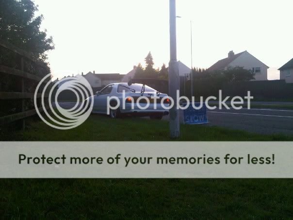

went for a spin and ended like this
this is regular sight for me!

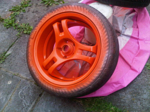

but in the mean time i sprayed my sa3r's
i didnt tape off the rubber as they need changing.

will fit them on once i have my fc back n get some new rubber for her which is coming from japan and landing next week :)
red plus white,, um good combo,, haven seen any red rim around in bolehland, is it very cold there, i have been cardiff once cold in summer man, love tropica.
