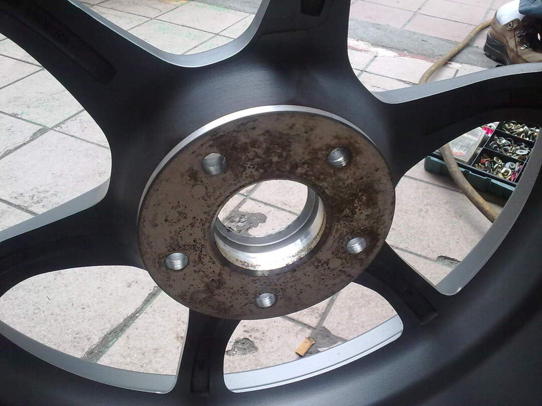

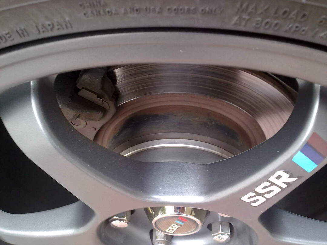

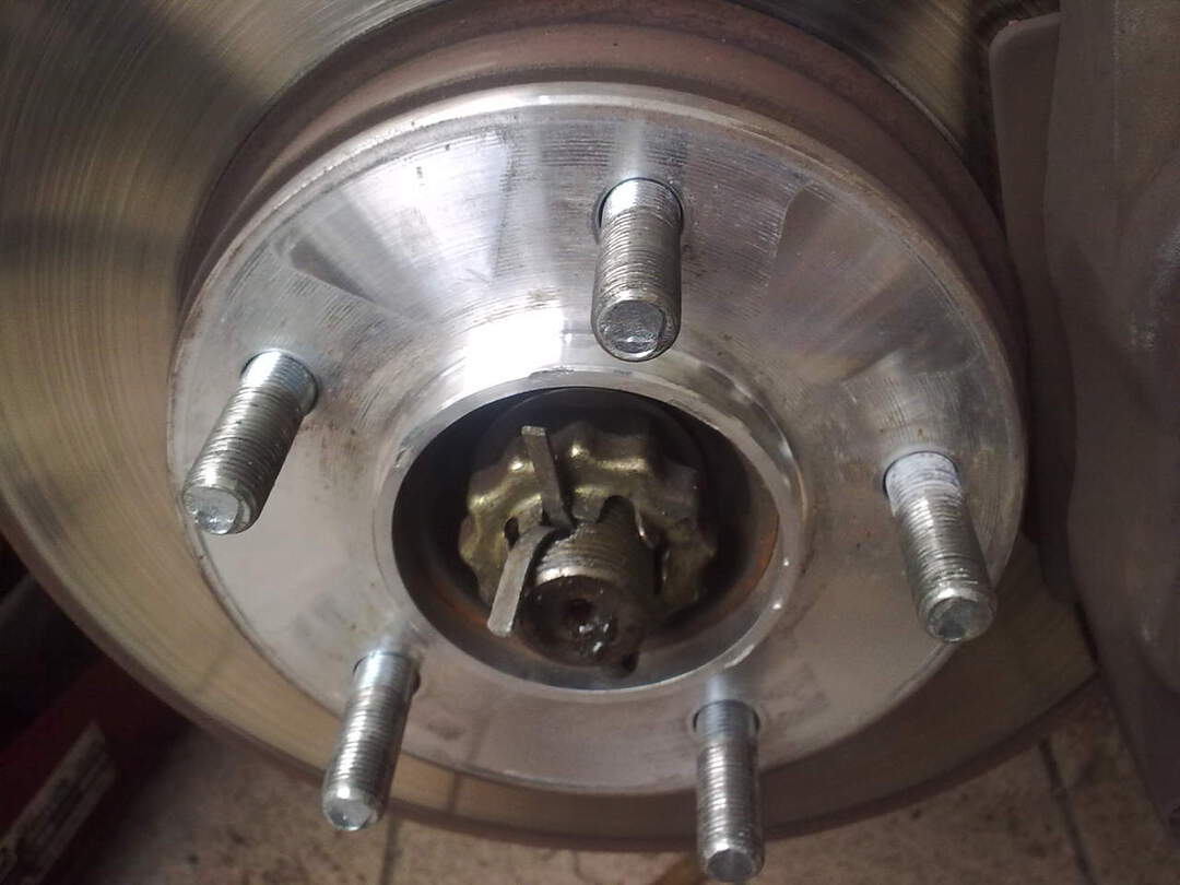

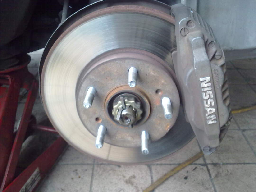

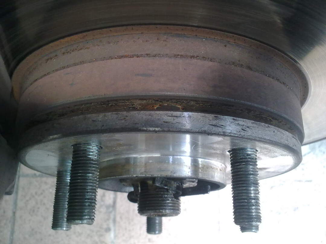

Try to use the S14 or S15 twin pot, but you may need a 9mm spacer to give some buffer. Attach is what I did.

after the spacer, what's the offset you're using for your rim?

Sorry bro, 4got liao, 1 year liao. I just calculate how much space I need to free out from the brake caliper, and change all the screw to longer 1cm, finally told the tire shop to custom make the spacer with center hold than settled, lucky the rim is giving a lot of freedom.
btw it will change the car handling in corner if you just put in the front spacer.
Silvia(S13~S15) and Skyline GTS use the same brake caliper, so as long as this type plug and play. Original brake caliper in high speed u knw it can stop but take sometime, but this one u will feel really can stop faster but provided your tire can handle it or not.
After add on spacer handling become better or worse ?
From other modify magazine wrote is better, but i changed rim with offset 35 from 38/40 but it become bad.
bro, mine's 40 (front) / 42 (rear), maybe you want to try to to different offset? i believe the tyre is OK....

If you just add infront, it will under not good for corner, if put at the rear it will over, it feel like driving a FR car, but dun push to the limit, it not eazy to collect it), if you put front and rear together you can put more speed in the same corner you normally did, it fast and more controllable too.
